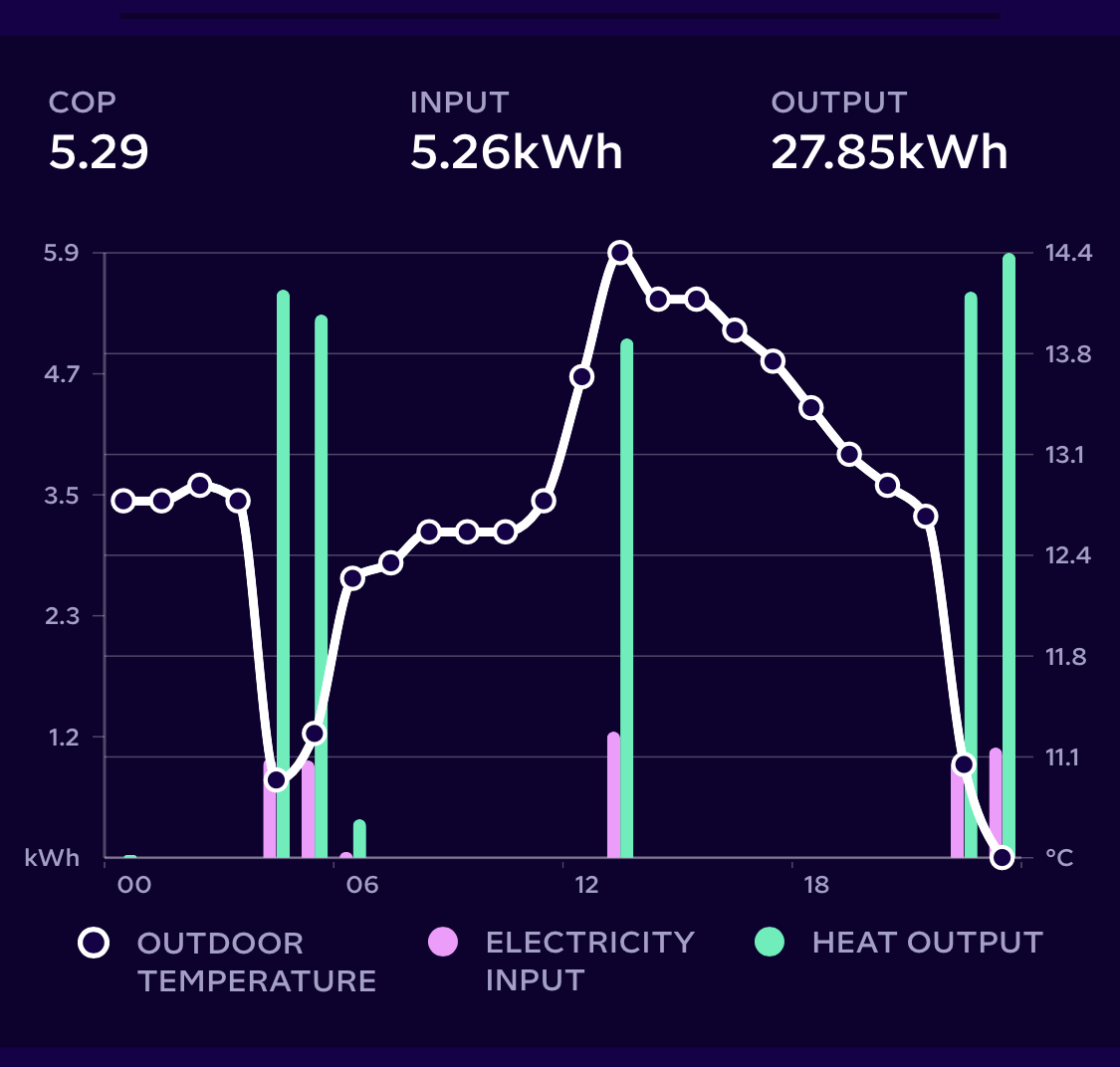

With the Heat Pump, I have the Cosy6 schedule set like this:
0-4 20.5C, 4-7 21C, 7-16 20.5C, 16-19 20C, 19-22 20.5C, 22-00 21C
I have hot water on at 13h which is when the outside air temp is warmest and the HP uses less energy to heat the DHW tank.
I did try heating DHW during the 4am and 10pm cheap slot but it used more energy and the HP kicking in on full heat was audible in the bedroom; I’m part way thru renovating the lounge and there’s no ceiling so noise transfer is an issue I will address later.
Here is what my usage looks like with the HP using the Cosy cheap periods it’s very efficient at a COP of 5 gives 2.6p/kWh
It's good that you can keep the whole house warm with the heat pump only producing heat at that period - during those gaps, a lot of the rooms in my house would cool down a lot.  Mind you, the OAT is quite high so it may well struggle to maintain the flow temp/deltaT.  Now it's become a bit colder, my heat pump is on a lot more and it's slower to warm up the room with the Primary Pod and thus other rooms stay warm - some are over heating.  It feels like I ought to be able to balance things out a bit to even things up.  My current COPs are running at 4.7-5.15 right now so pretty pleased with that.
