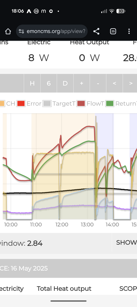

I set the cosy 9 to 70C fixed flow today and let it have at it.
Super interesting, when it reached 60C flow it began widening dT instead of flow temp.
I'm not so sure this is a great surprise, there is not much it can do about DT unless it can ramp up the water pump speed, which at some point it will be unable to do even if it tries!   Perhaps more interesting is that it manages to manages to maintain 70C ft, suggesting a fair margin in capacity.

@jamespa it seems to run at max 27L/min until 45C and then ramps down to 14L/min at 60C then stays there at 60C 14L/min.
I was absolutely cooking so I'm sure maybe my TRV had closed I couldn't emit 10kW possibly.
Curious that it reduces the flow rate at higher flow temp.  I wonder what the logic is of that?  If it were looking to maintain a specific DT then it would need to increase it.  Perhaps its trying to ensure that the return temp isn't too high for some reason?  Reverse engineering control systems for heat pumps (and many other things including doubtless boilers) can be fascinating!

@jamespa https://emoncms.org/app/view?name=Cosy+9&readkey=9c733f17f0fd7a3816ec0db72d96e857&mode=power&start=1764066130&end=1764069780&flow=1
Run starts at 11.
It didn't do a defrost the blip in the middle is me canceling a HW call.
