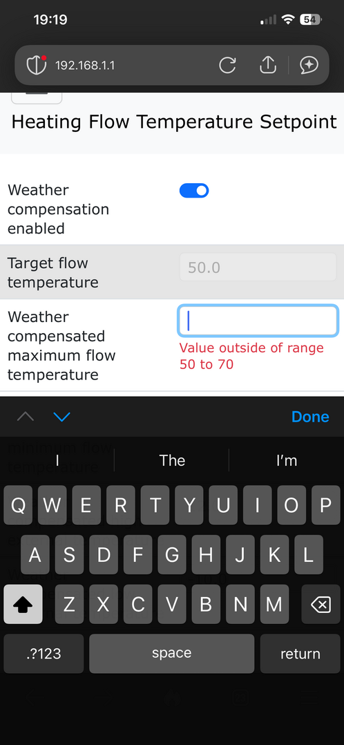

(@agentgeorge)
Posts: 194
IMG 6705
I got into the cosy hub settings and found the WC settings, you can put a number into the box, I tried 45 and it displayed the red warning, and changed it to 50.
So a real Octopussy Man is required here 🙂
(@andrewj)
Posts: 259
Posted by: @agentgeorge
IMG 6705
If you saw it with your own eyes I wouldn't attempt to dispute it!  It isn't what I thought - I may ask the engineer who's visiting on Thursday if that's the case, if I remember.  I hope that the maximum flow temperature isn't hard-coded to a value of 50, that would be a bit of an issue in stopping the house overheating - I'd have to go back to a thermostat.
