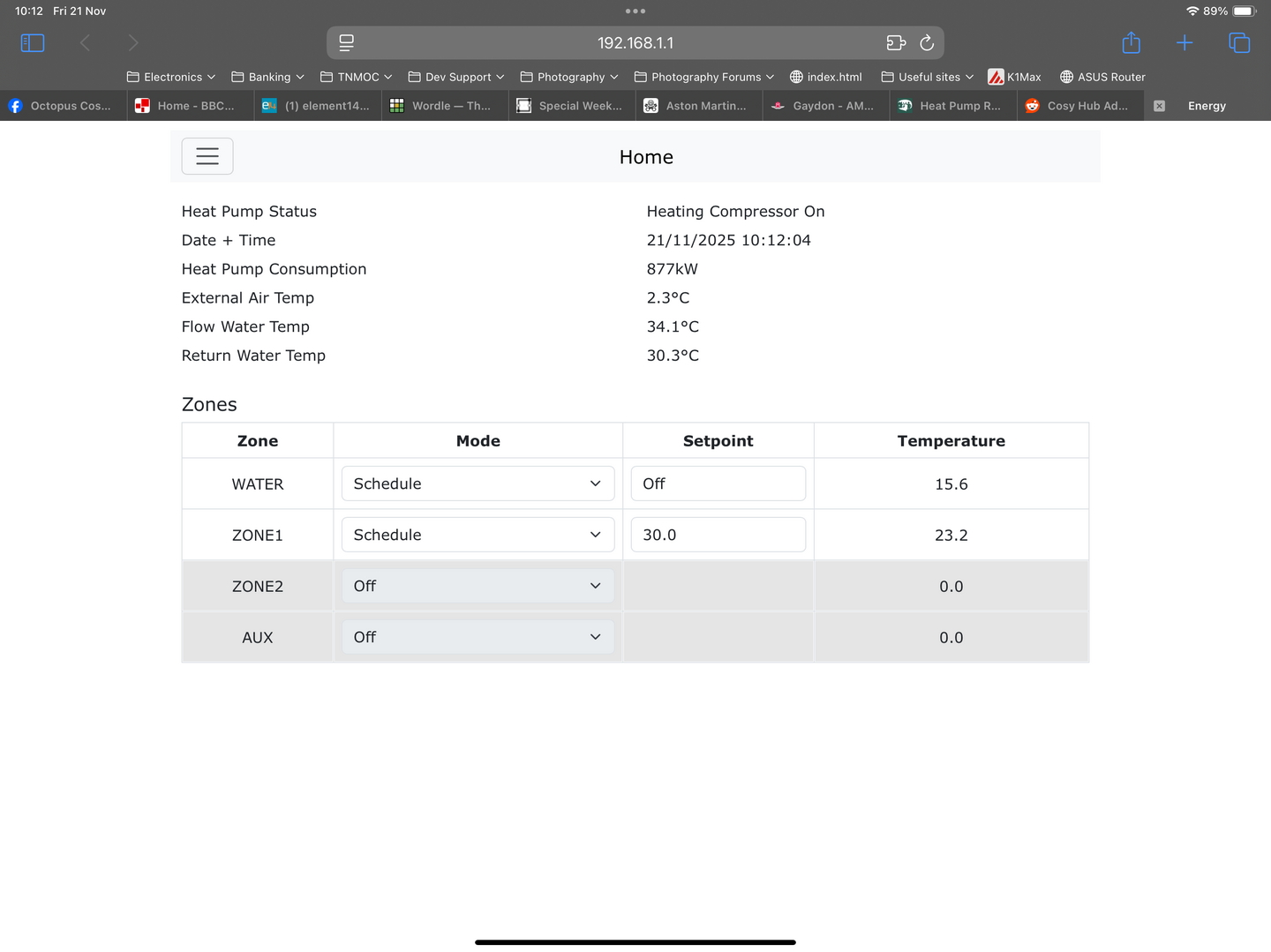

I have also managed to get into the Cosy Controller which gives me some minimal info - other data requires an installer code which I don't have.  The flow temps at 10:12 are shown in the image and are at a deltaT of 3.8c.  Unfortunately After Care can't see the flow rate so I have to wait until next Thursday for the engineer to tell me.
I haven't screwed all the LSVs down - none are fully shut and two are fully open.  I'm not going to make any more changes to the WC curve until I see the engineer as I don't see the point.  I am going to have to use the TRVs on the Study and the Landing as I'm sitting here at 25.2c and sweltering!  I'm also going to turn it down in the bedroom as 24+c is too hot.  I presume that is unlikely to affect anything with 15 radiators in the house plus a volumiser but is there anything I should look out for?

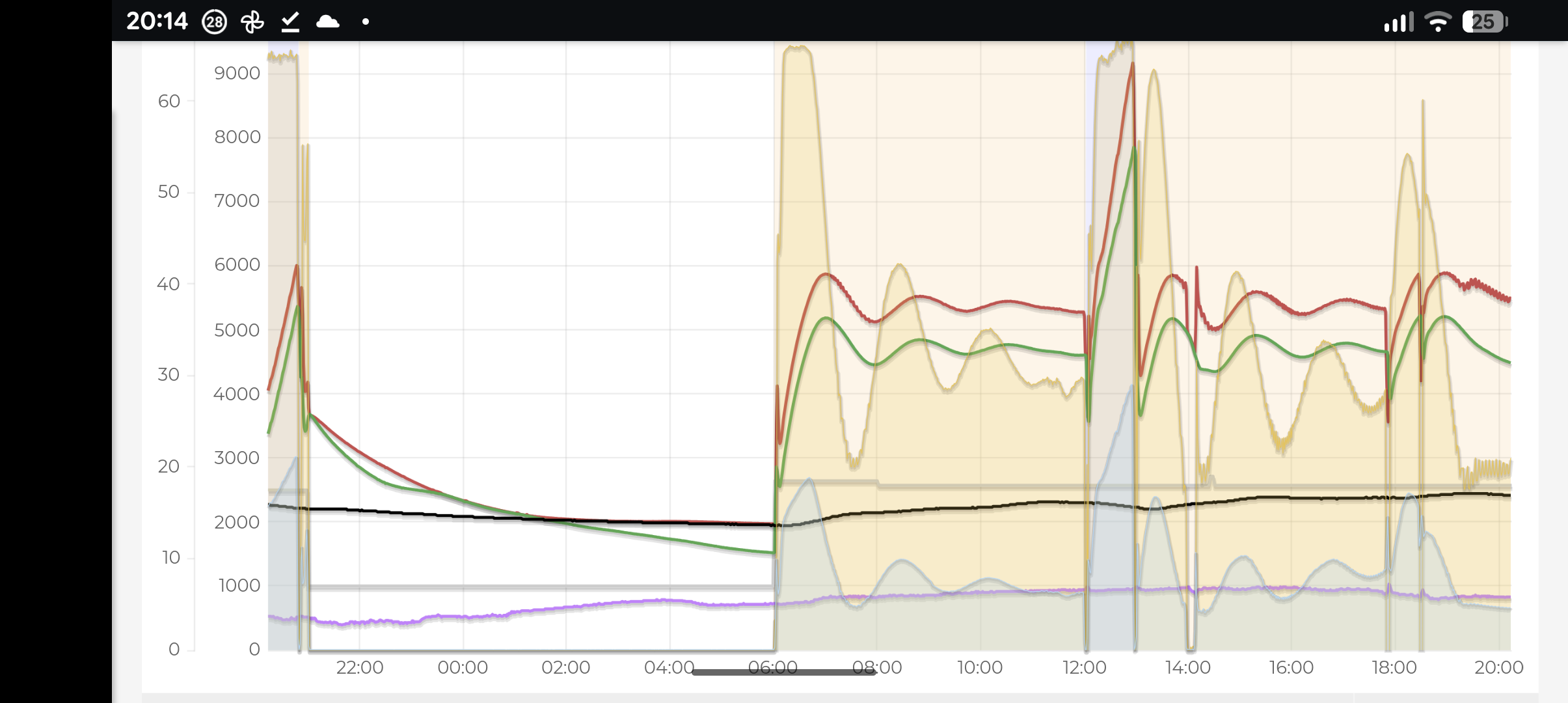

(@swwils)
Posts: 97
It definitely doesn't have a regular weather curve control algorithm. Unless you "force" it too by setting a room target very high.
Screenshot 20251122 201451
This post was modified 12 months ago 2 times by swwils

(@andrewj)
Posts: 259
Posted by: @swwils
@swwils I don't know what you mean or what I'm looking at, could you provide an explanation please?  A few posts ago I asked you a couple of questions that I hoped your insight could help with if you could take a look please.
(@swwils)
Posts: 97
@andrewj Certainly mine cycles alot below 36C, it seems "happier" with the weather compensated minimum flow temperature at 36ºC or above. I think the really old manual also mentions this.
If you go back to generic basics, you must have correct pressure differential for as-designed compression, you need to avoid suction flooding, keep the inverter in its stable torque region. So if you go "too low" the pressure ratio becomes too small, and the compressor is basically pumping nothing.
Looking at some of my data, the pump really wants to maintain a set ΔT, so as you drop the minimum LWT really low the return water might only be 1–3 °C lower and destroy your COP.
At mild outdoor temps, your house may need <2 kW. So for my 9, the system must cycle and minimum flow temperature being too low makes it worse, because the compressor surges on start, return water spikes, unit trips off, repeat.
This is why dropping the minimum WC temp only increases cycling and reduces efficiency.
