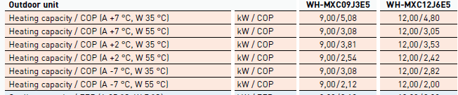

I'm afraid I find your maths very confusing. If you look at the table for your heat pump, that you provided, you will see that the manufacturer states that the anticipated COP value at an outdoor temperature of 3C and water flow temperature of 46.55C would be in the region of 3.
To consistently produce a COP value of 7.4, would require the water flow temperature to be in the region of 25C.

Based on the data supplied by ASHP manufacturers, for an ASHP to produce a COP of 7.4 would require a water flow temperature of 30C at an ambient air temperature of approximately 15C. For each kW of electrical energy used the heat pump would need to extract 6 kW of energy from the outside air, which becomes more and more difficult at low ambient air temperatures.
It is the laws of Physics and Thermodynamics, energy cannot be created or destroyed, it can only be changed in form.

Here is the spwcf for the 12 Kw unit installed.

Heat pump manufacturers must provide data that shows the pump's performance at different temperatures and flow rates. I'm sure you can achieve high COPs with low flow rates (as you've stated). So it comes down to insulation. If my house is passivhaus standard, I can get away with 25C flow rate. But most houses are not that well insulated so we need to run at 35-45C. Brendon says there's nothing special about the house in Glasgow that he installed the system in, so I don't see how you'd get away with a really flow rate.
I've also not seen any heat pumps on the UK market that make a COP claim of 7 at 3C ambient. If this COP can simply be achieved with any heat pump by simply bypassing the buffer tank and disabling all thermostats and TRVs, then the UK installation industry has a lot to answer for because they will have installed hundreds of thousands of heat pumps incorrectly.
@derek-m You are wrong, there are a lot more peramiters involved than you think, the inverter system running at low load is increadably efficient as the collector can be up to 6 times larger than at peak. All measurements are done at peak. In addition,the inverter it'self can reduce efficiency by up to 60 % from most efficient point to worst (just like an engine as it goes up the rev rainge).
The manufacturers do not give you this data, I have spent many years working it out in rela life scenarios to get the best possible output and performance for my customers.
