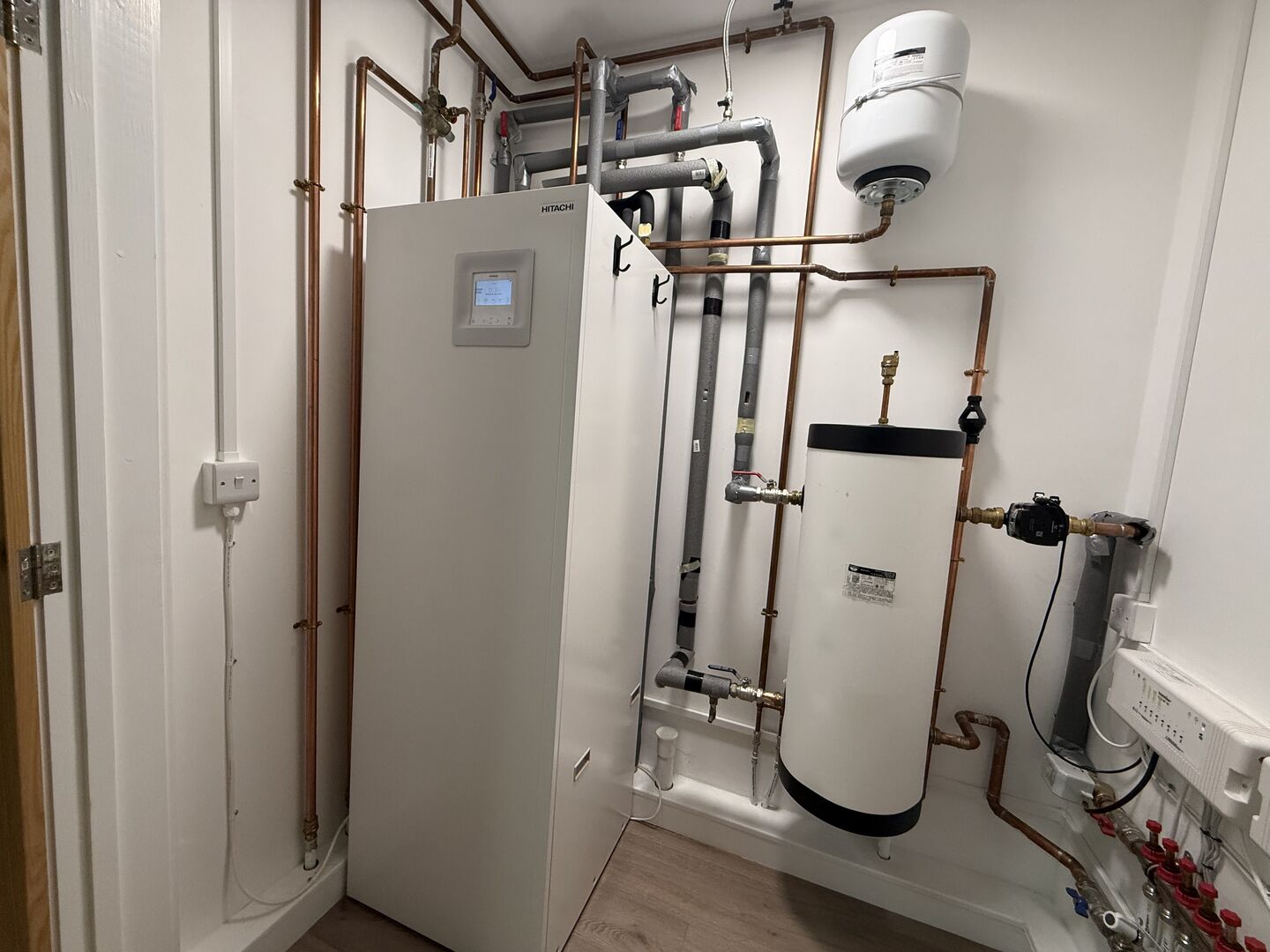

Today we start the replacement of our 2-year-old split 7kW Hitachi Heat Pump. Being replaced with a Vaillant aroTHERM plus 3.5kW. The unit is being replaced because it’s over sized for the property and has so many quirks:
- Requires constant management, which a non-technical person could not to manage
- Performs defrost even at OAT 15C
- Poor COP during defrosts and cold periods
- Defrosts every 35mins irrespective of evaporator or outside temperature
- Erratic performance, have to turn off to reset
- Split system not suitable for this property
- HP is operating close to its minimum operating performance characteristics
- Short cycling is managed by a SW fix which monitors temperature Flow Temp and waits for a 2C drop before restoring heat.
As Mars would say “Its like managing a patient on life support”.

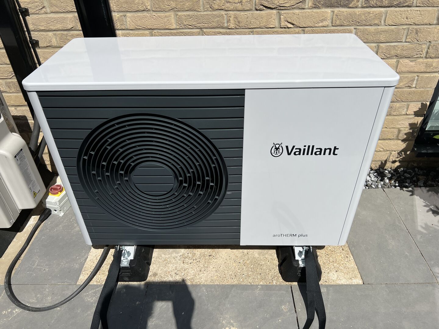

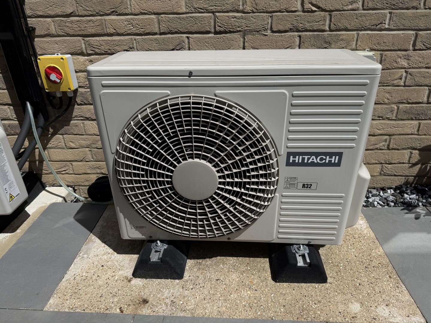

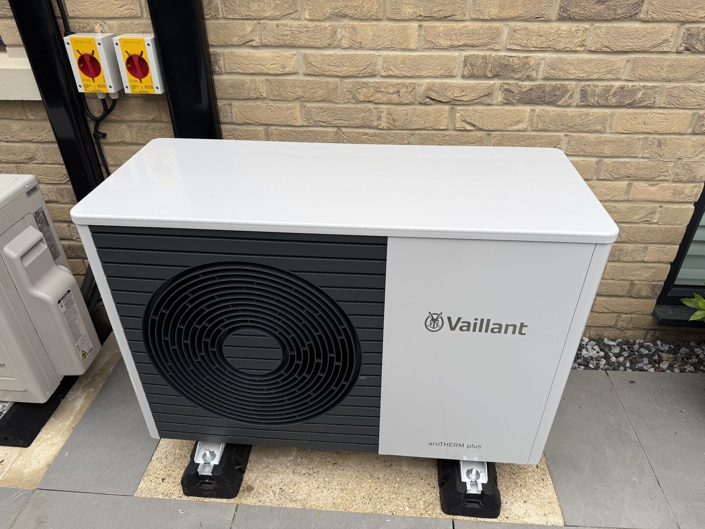

Today’s activities:
- Returned R32 refrigerant to HP
- Removed Heat Pump and Internal Water Storage unit (125Kg)

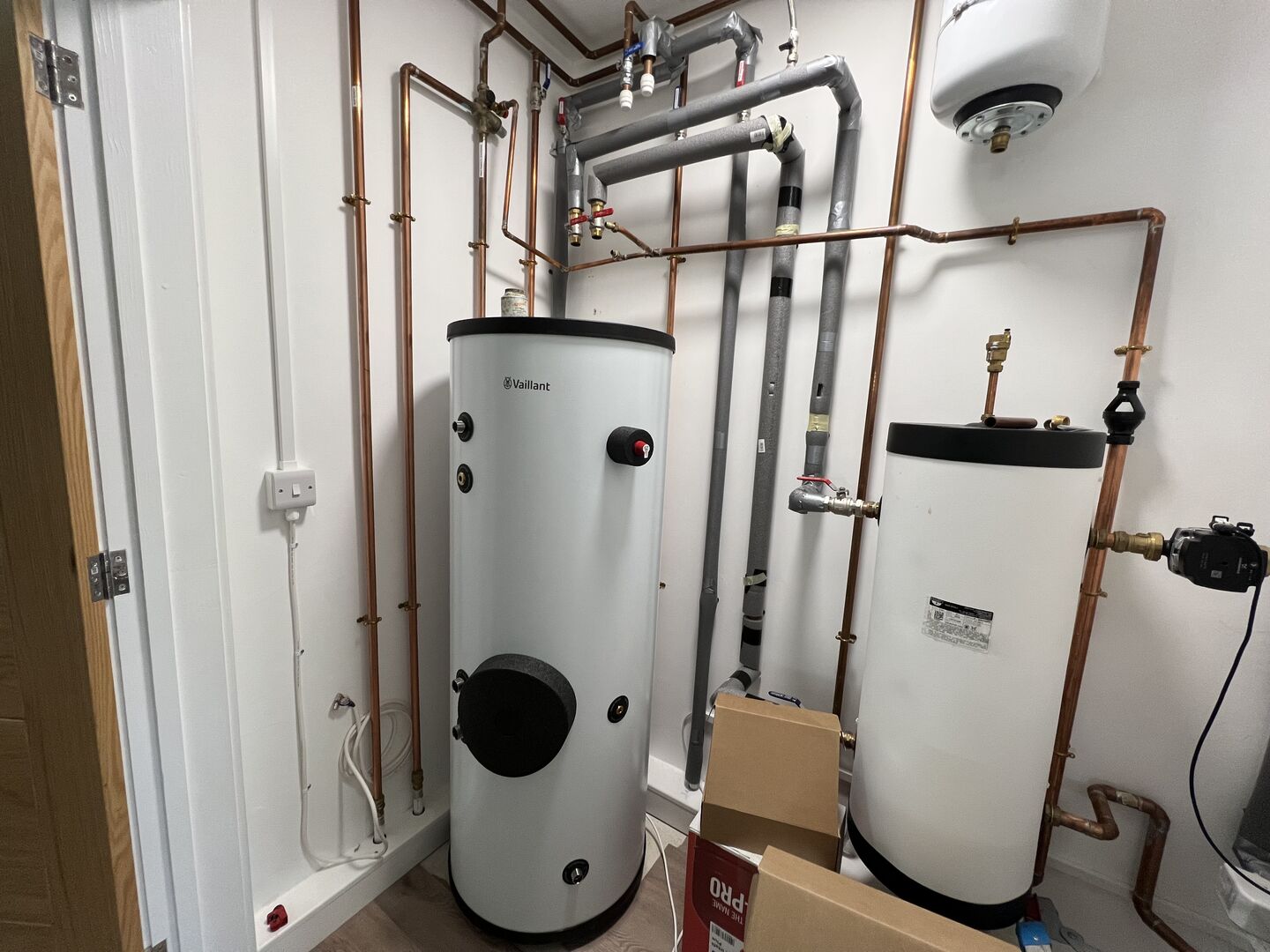

- Hole drilled in slab for defrost drainage
- Vaillant HP and Water Storage placed
50 litre volumiser
3.6KW solar panels
Tesla 13.5kw Powerwall 3

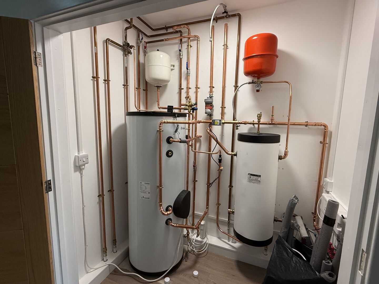

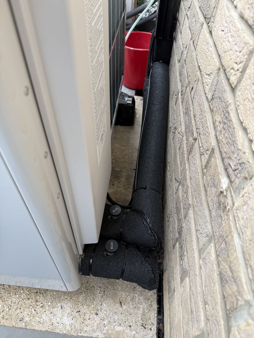

Great news that work has started but...is that a 4 port buffer I see before me, its auxiliary pump to the right? If so I strongly recommend to get it replumbed as a volumiser. Your UFH is all the buffer needed and more besides!
Posted by: @jamespaGreat news that work has started but...is that a 4 port buffer I see before me, its auxiliary pump to the right? If so I strongly recommend to get it replumbed as a volumiser. Your UFH is all the buffer needed and more besides!
Yes to be configured as a volumiser. The pump is to be removed.

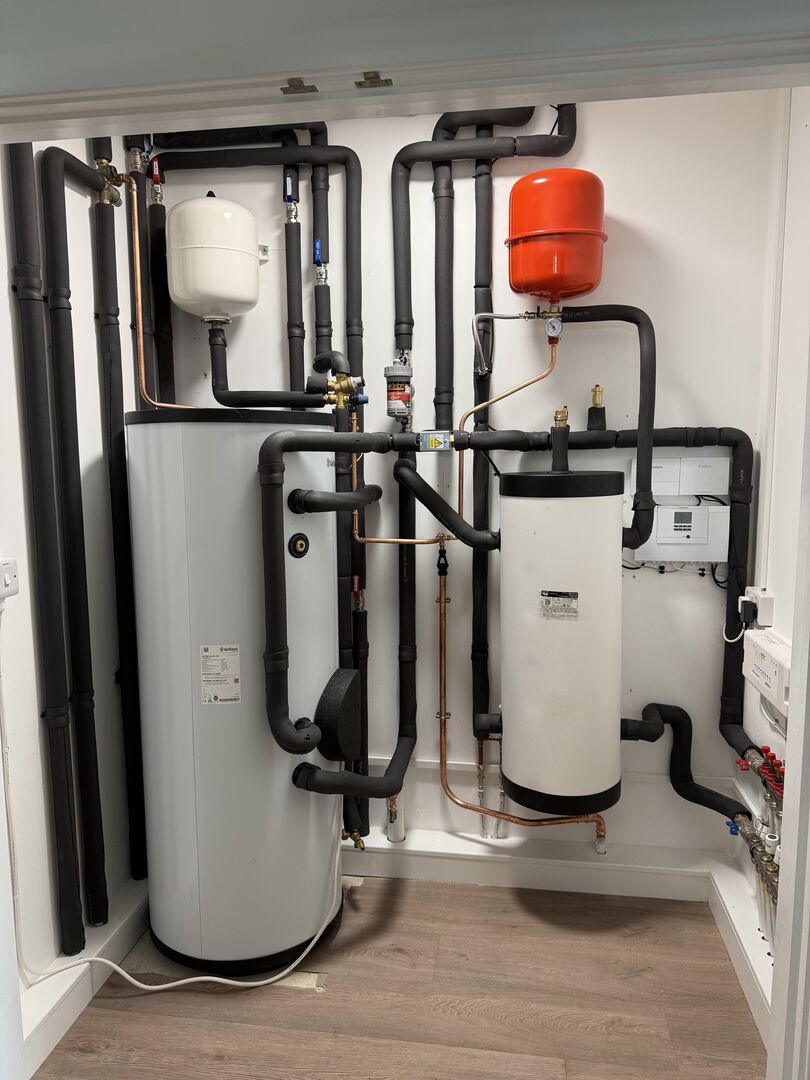

@trebor12345 Nice use of spare ports on the buffer turned volumiser to connect various bits!

Also not bad in terms of duration, showing that in case of a failure of a heatpump, a new one can be swapped into position in a few days..
Posted by: @batpredAlso not bad in terms of duration, showing that in case of a failure of a heatpump, a new one can be swapped into position in a few days..
4 days, but it was an easy install for them.
