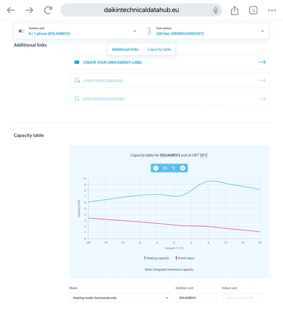

Quick question, if octopus is correct about my heat losses (6.4kw) will  the 8kw daikin big enough during a cold snap ? I ask because at a low temperature that machine loses a lot of power (only 3kw at -7 or so)?

@pie_eater If it is of any help, OE carried out a survey and my HL is 6.5 kW and they specified a Daikin 8 kW ASHP. This is what we had fitted though not by OE. When we had minus 7 or minus 8 last winter, the system coped admirably - and we have the temp. set to 22.5 degrees C; the system is on 24/7 with a slight setback at night. We use Homely to control the system and if I remember correctly, the lowest COP we saw then was approx. 3.5 and most of the time, we have a COP of 4.5 or more. Regards, Toodles.

@pie_eater Is it one of these models? If so they all seem to do much better than 3kW at -7C OAT. Where did you get that figure from?
I had a quick look on heatpumpmonitor.org they have several octopus installed Daikins this one is an 8kw one and the owner states its output as 5.45 kW @ -3°C. you can see his stats here

@pie_eater Here:

I take it that you are looking at the red line and not the blue line.

@derek-m  I was looking at both specially the red line for costs . I've posted those images before but no one said anything. Is heating capacity not what I think it is? It's not an indicator of capability?  🫣
The blue line is how much thermal energy the heat pump should provide, the red line is how much electrical energy the heat pump would be using.

Ah helpful thanks . It’s the EDLA08E2V3 so yes I think that’s in the graph
