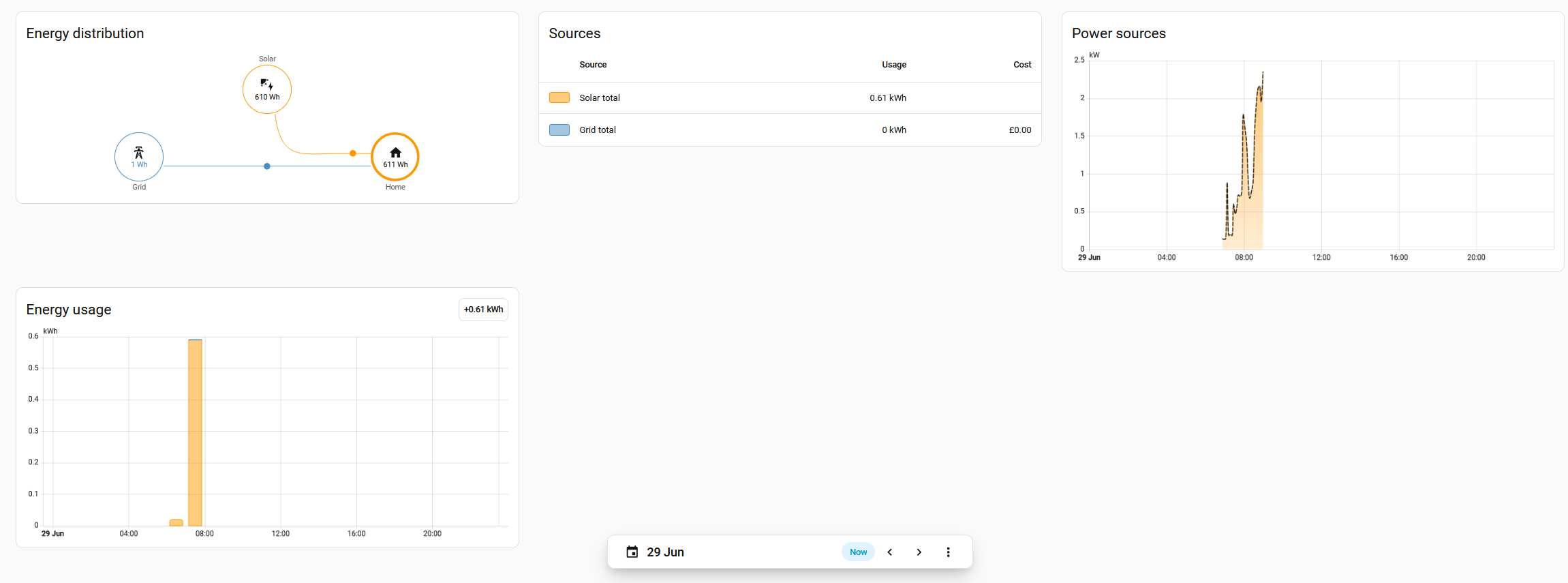

I note that you paste the panel as an image, without a link that people can click "View given feedback" to see what happened. HA seems not a friendly community in my experience. If one tries to write something to cover a gap in the documentation, if you can even extract the information on it from people to do so, 7 people will tell you that it should be done in a different way and 3 will tell you (more or less) to go fondle yourself for daring to suggest their beloved project is less than perfect yet.
I remain of the opinion that Open Energy Monitor is better open software for monitoring energy use... I'd make the python script output to MQTT, then let emoncms collect it and draw pretty pictures.
Posted by: @mjrI note that you paste the panel as an image, without a link that people can click "View given feedback" to see what happened.
I'm sorry, I am not sure what you are getting at here. They are meant to be images, images that show the appearance of the panels, not intended to be interactive in any way here (though they are in part in real life, you can scroll and zoom in and out).

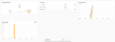

So I have (once again) taken the plunge into Home Assistant (HA) with a varying degree of success. So far I have set up an old laptop with the HA OS and integrated it to my EmonPi, Huawei inverter and Octopus Home Mini. Its a steep curve when you are not used to working with it. Im dabbling with the idea of adding Predbat if all goes well, but it probably wont so I will be asking for help im sure 🙂
It can definitely be a steep learning curve if you choose a goal early on that needs some more arcane or advanced functionality (which is often the case when dealing with manufacturers who want to push you towards using their in-house solutions - most heat pump and solar PV manufacturers, for instance). However, the curve you have to climb is also often relatively short so after you've got your head around a relatively small number of foundation concepts (the steep bit), things can start to come together and make sense quite quickly from then on.
All that said, there is a VERY good case for sticking to the KISS principle. Predbat is a very clever bit of programming that can certainly save you money, but my experience is that you can get about 90% of the benefit from a handful of much simpler automations. If you want to squeeze the last drop of benefit from your kit, predbat is worth a look. If you want to avoid the steep bit of the learning curve, something more basic is probably the way to go.
