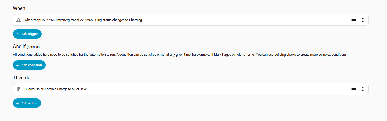

@majordennisbloodnok Ive been thinking, and Im wondering if I have been a bit too simplististic. My automation below, just detects when the EV is charging and sets the home battery to forcible charge if the SOC is less than 95%
I think this should work fine during night hours on IOG and if the battery is already charged, then it will have no effect, and if it isnt then it will charge the battery at cheap rate along with the EV. When the EV stops charging I have another automation that cancels the forced charge.
I then got to thinking, what would happen when IOG charges outside of the cheap rate window, presumably if the battery is below 95% then it will start charging along with the EV but still at cheap rate. So far so good.
But then I thought what will happen, if I plug the EV in during the day and it starts charging because I have surplus solar for example?, Now the battery could start charging when it isnt at cheap rate. But will it actually draw from the grid or just attempt to share the solar surplus?
Could this situation be prevented by changing the default mode of the Zappi so that it doesnt use excess solar? Or should I add another condition that detects when I am exporting solar? How do you handle it? Cheers in advance 🙂

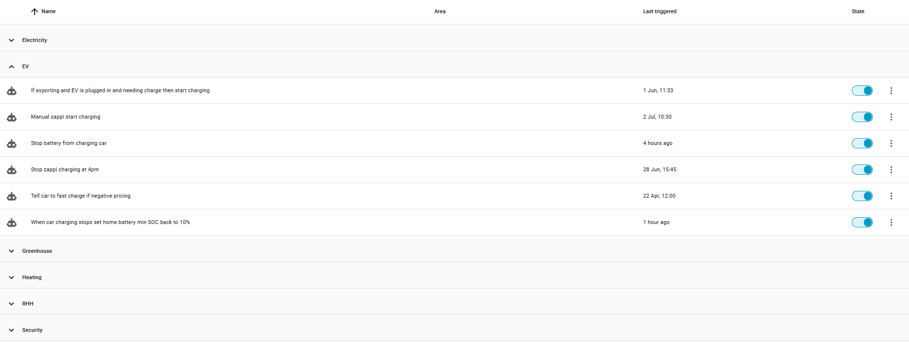

I should also add that I have several automations for various scenarios, as listed in the screenshot below.
