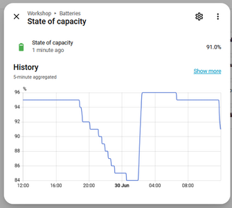

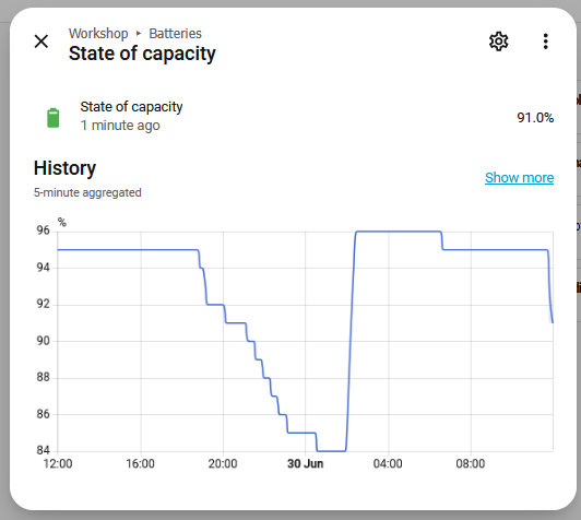

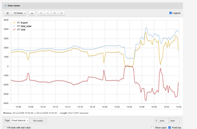

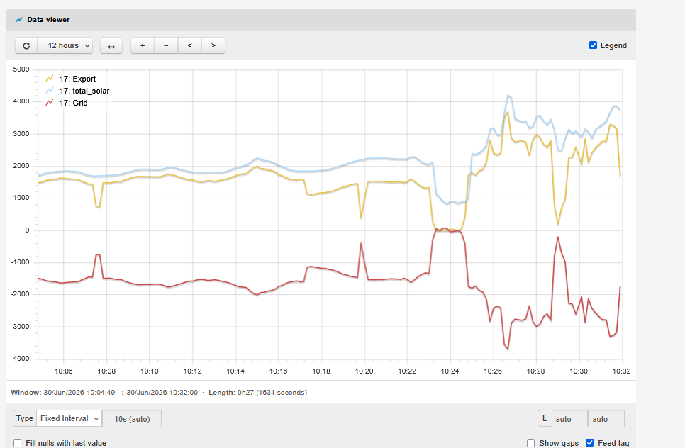

@majordennisbloodnok I think it worked, no errors reported, but the sun came out between 10:25 and 10:30 when I set it to run, so it was difficult to be sure 🙂

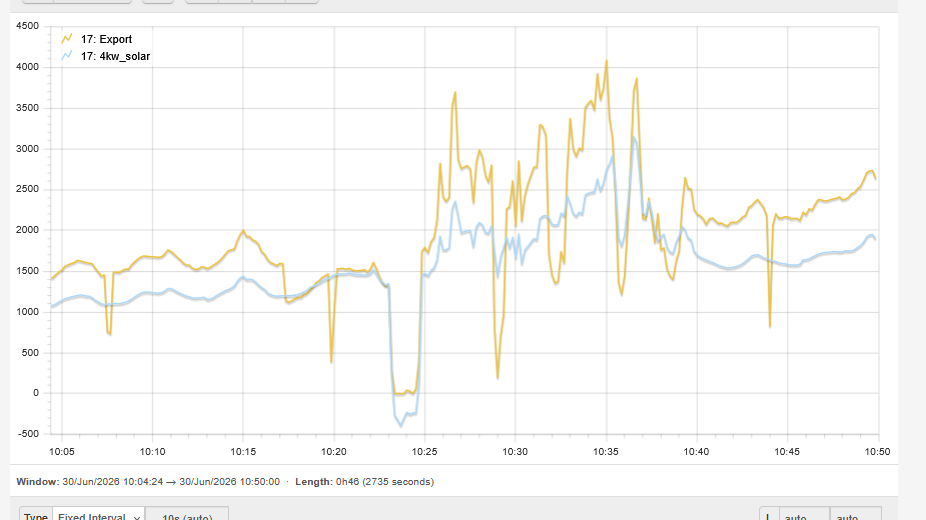

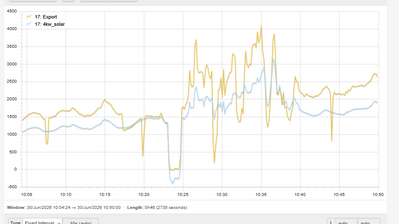

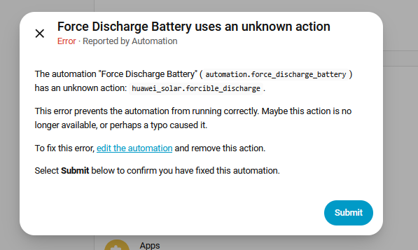

Not so sure now 🙁 No errors but set this for 10:45 to 10:50
6.9 kWp of PV
10kWh DC coupled battery
bontwoody
(@bontwoody)
Noble Member Contributor
Posts: 1063

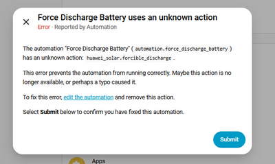

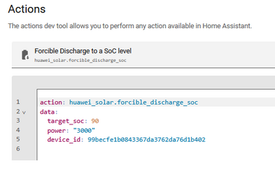

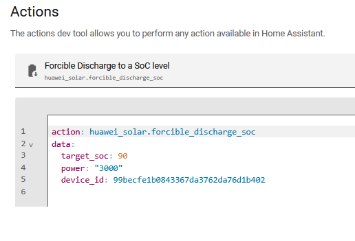

@majordennisbloodnok Looks like its the target SOC thats causing it
Log details (ERROR)
Logger: homeassistant.components.automation.force_discharge_battery
Source: helpers/script.py:2185
Integration: Automation (documentation, issues)
First occurred: 10:25:00 (3 occurrences)
Last logged: 11:10:00
Force Discharge Battery: Error executing script. Invalid data for call_service at pos 1: extra keys not allowed @ data['target_soc']

(@majordennisbloodnok)
Posts: 2204
That would suggest you've got forcible_discharge in your script with a data section containing target_soc rather than either using forcible_discharge with no data section or using forcible_discharge_soc with the data section.
Oh, and that target_soc was only the result of my trawling around the interweb a bit. The documentation is rather light on that front.

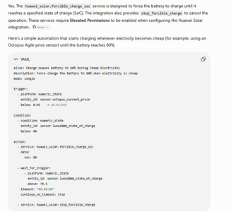

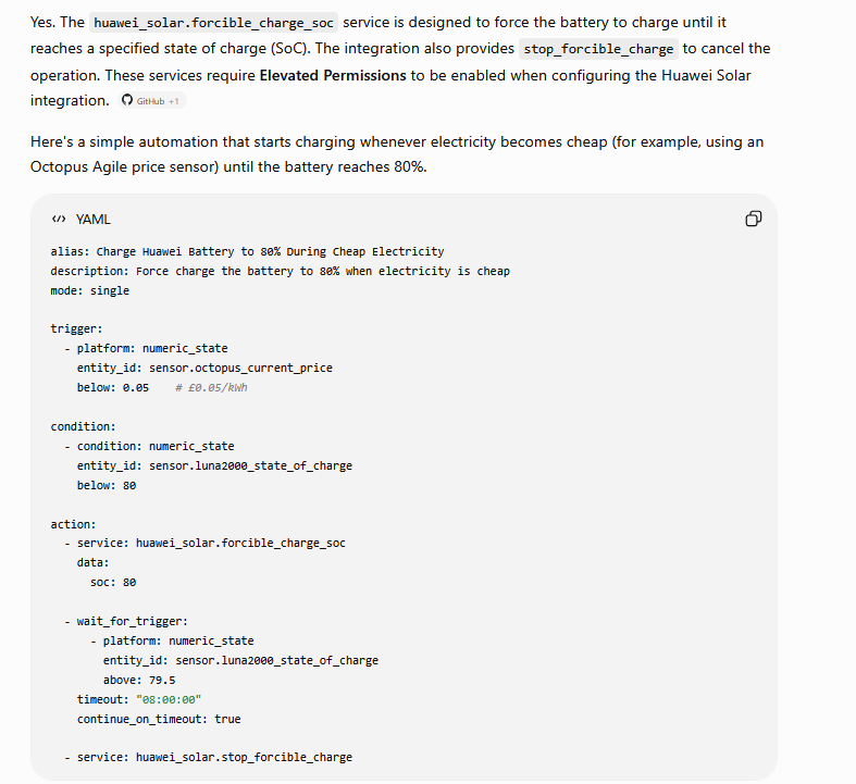

@majordennisbloodnok Just chatted to GTP and it came back with this 🙂
Cracked it. Newer version of the integration required syntax change. Thanks for your help on this 🙂
