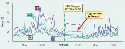

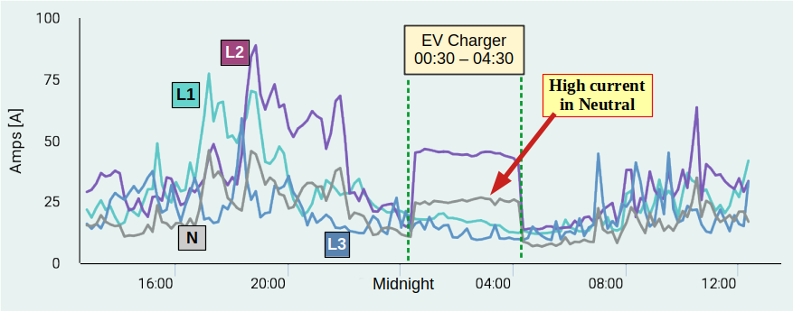

while your battery is charging with cheap grid power, your heat pump will run a bit harder [...]    ("loadshifting")
... a mode of operation which increases losses due to phase imbalance at the local substation
... and thermal stress in underground cables because of high current in the neutral. 🤨

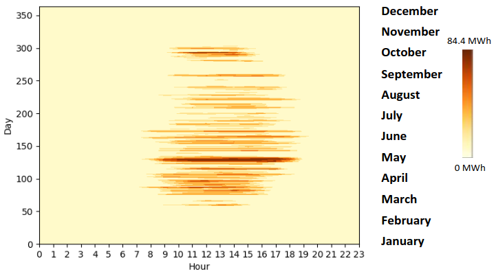

ANM Plots are no longer published,
but here's one from about 5-years ago from the Grid Supply Point just west of Exmoor.
The darker the colour, the less electricity can be exported from the generation site which was being proposed.
Alverdiscott S.G.P. East Yelland Bsp 132kV 84MW

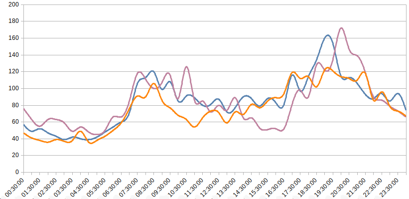

The early evening demand-peak is characterised by a decrease in line-voltage (corresponding to the higher current being drawn).
This graph shows the 3-phase current drawn on one Feed from a local substation in a small town with a population below 20,000

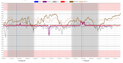

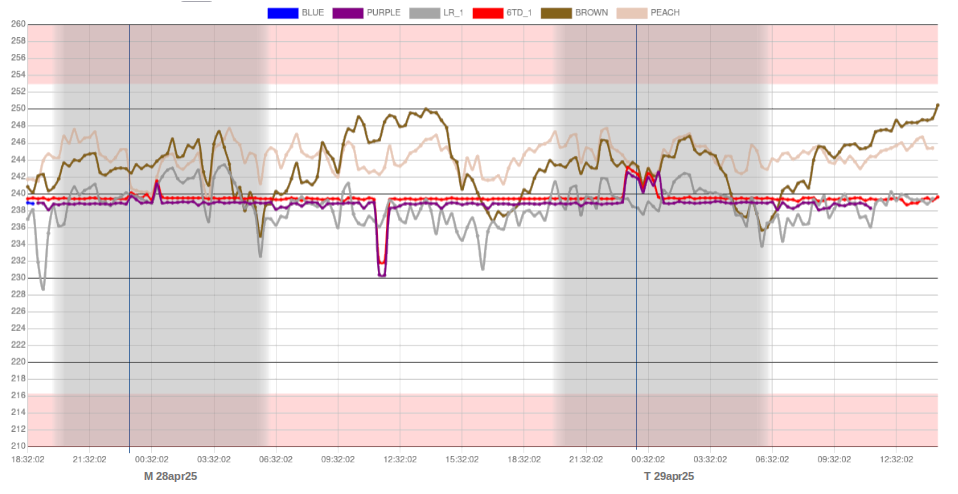

Here's a line-voltage plot from a month ago (April'25).
It shows no correlation to the theoretical early-evening peak.
48hr 280425
Ignore purple and red. Those are reference plots.
Brown, Grey and Peach are LV Monitors placed on local substations, each supplied by different 11kV lines from the same Primary Transformer.

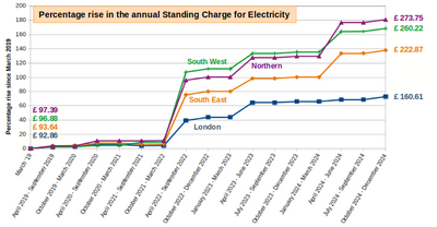

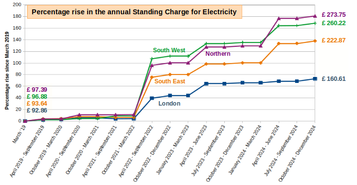

That's reflected in the rise in Standing Charges since April'22
SCrise Mar19 Dec24
We can't keep living like that.
