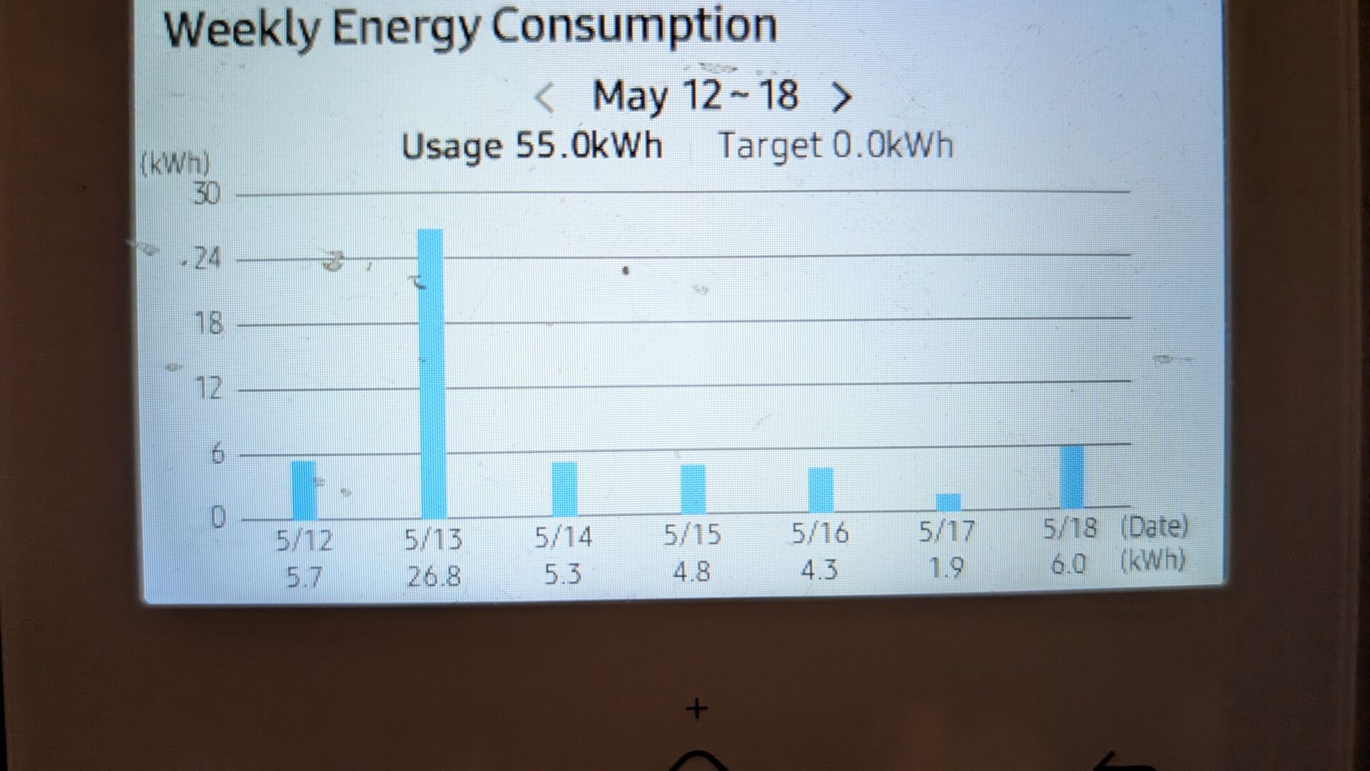

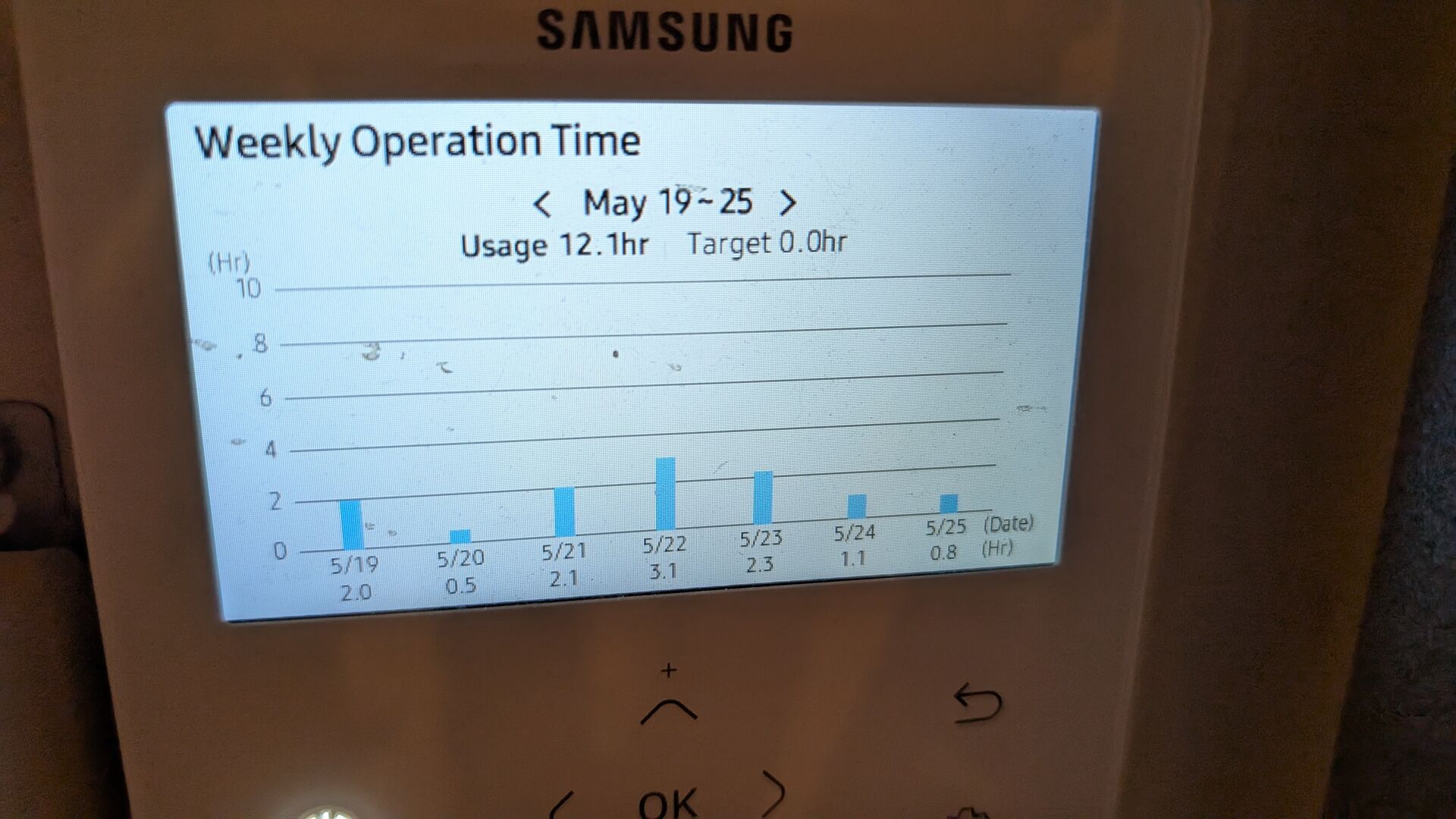

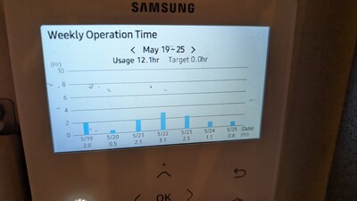

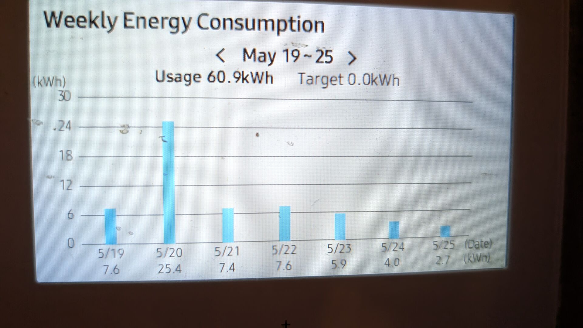

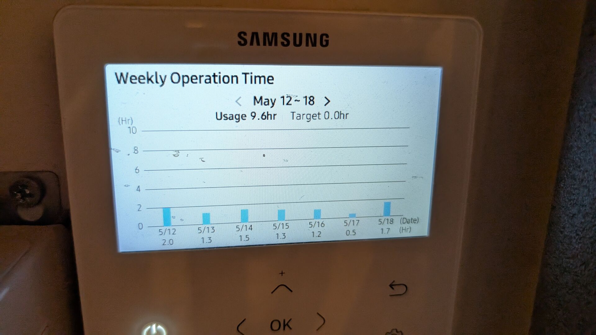

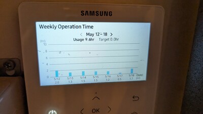

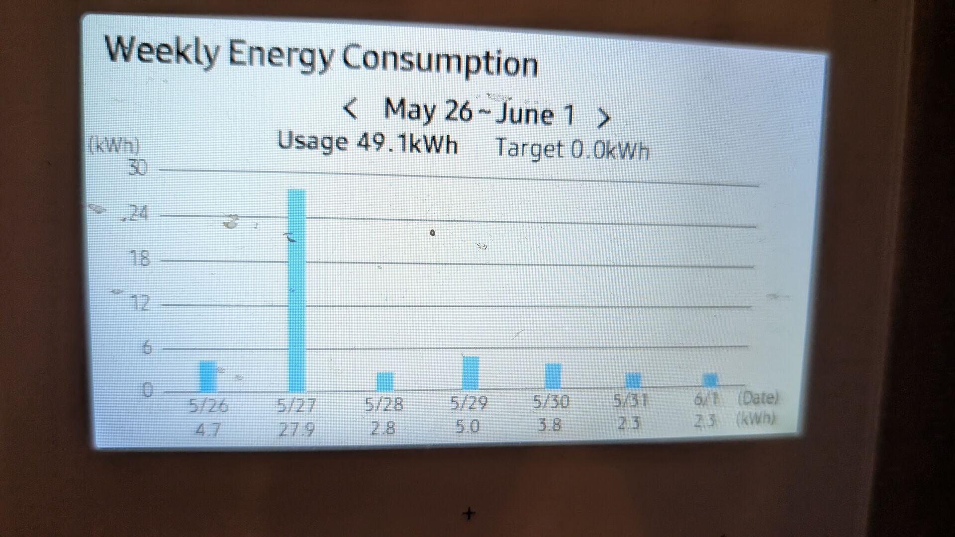

(@terry)
Posts: 10
@hcas thanks, I didn't realise I could look at energy. Usage attached, operation time too
So it seems to be using very little, except for Tuesdays when it does a legionella cycle (would that explain the 60c? Although my 60c photo was a Wednesday)
PXL 20250604 104500761
PXL 20250604 104512768
PXL 20250604 104507398
PXL 20250604 104615243
PXL 20250604 104608742
 So looking at my octopus account my electricity usage is only a tiny bit up on Tuesdays, which makes me think the heat pump isn't a great contributor and I've sent you all on a wild goose chase.
Sorry but thank you for educating me on my ability to view energy usage.

Posts: 24
Looking at the figures on your screenshot, it looks like the legionella cycle is costing you about 18kWh extra on the Tuesdays.
It takes 17.5kWh energy to heat 300l of water from 10 deg to 60 deg so I think you might want to look closer at your water heating.
The operation time hints that you're using the immerser to do your water heating.
Assuming you are using the heatpump on a not cold tank to do your water heating this electricity consumption seems way off.
(@terry)
Posts: 10
@derekdeleon hello
So you think I'm using the immersion all the time for my water heating. Rather than the heat pump.
I could see how that would treat the electricity.
Just seen the comment above. I'll  check the setting
