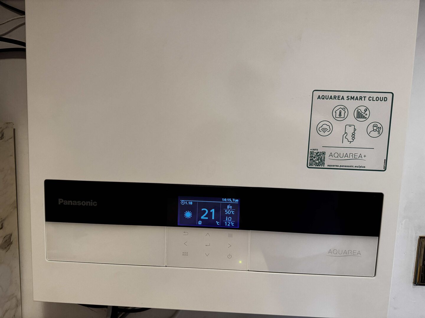

Before and after pictures. Old Daikin System ( 2 x 16 kw) split with 700l Buffer.
New Panasonic system 25 kw mono bloc with volumiser and thermo syphon system for log stove back boiler.
Really appreciate the lack of noise from the split units in the house. Two new radiators in the far side of the house
Brendon and Jordan from Heacol have done a great job designing and installing the system.
Upstairs now at 17 to 18 C and downstairs at 20 to 21C when outside at 0C. NB in all rooms unlike before.
Installed from mid January but commissioning delayed as storm Eowyn knocked out electricity to area.
Some tweaking heat curves to get to the ideal.
This was one of the first of the new large M series Panasonic units in the country and it is a beast of a unit.

Our new ASHP system was installed in mid January and for the first time in 16 years the house has been consistently warm - especially my home office where previously even mid summer required a pullover.
We have not had to use log burner in several weeks.
We have upsized two radiators, relocated one, added one for thermosyphon and found out that underfloor heating valves were not fully functioning.
Downstairs is a consistent 20 to 21 C and upstairs 17.5 to 18 C.
COP was 3.4 today.
The plant room has been returned to a utility room that means everyone is happy.
Brendon and Jordan from Heacol have been with us throughout and have consistently stepped up to improve the system and resolve any niggles.
This included replacing the Panasonic awkward in line filter with one in the plant room, adding open source accurate monitoring and also adding an interior thermometer so that the unit reacts to house inside temperature rather than flow temperature. A comms issue with the outside unit that required a temporary walk around was resolved quickly today.
The unit is accurately responding to outside temperature in both flow temperature and energy required.
In the Aquarea app screenshots the yellow is heating and orange is DHW. The black line is outside temperature.
Yes this is a big house with a big heat loss but we now have a system that works and we expect running costs to go down vs the 2 x 16 kw systems.
