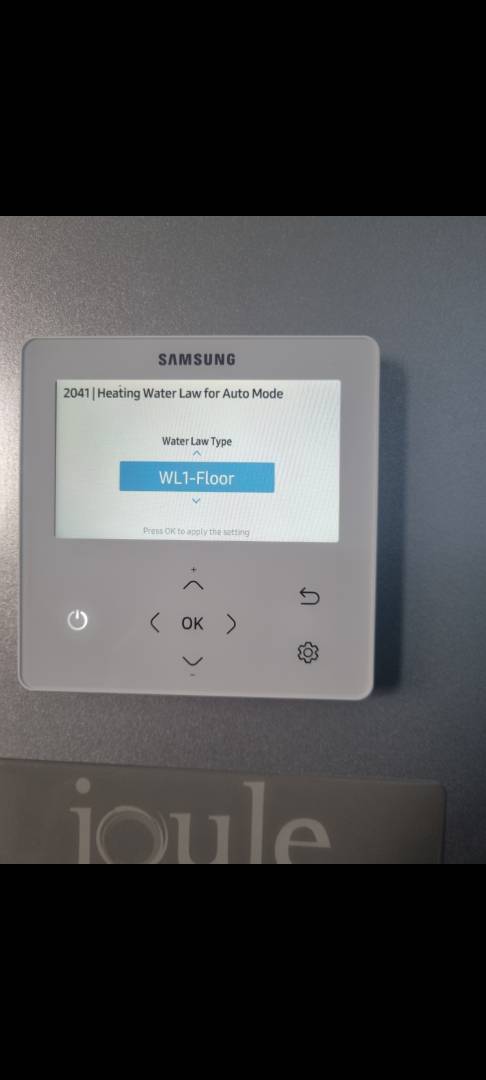

What water law settings are applied at the moment?
(@craig1980)
Posts: 146
@derek-m the airing cupboard door is always shut. It doesn't get that warm in there.

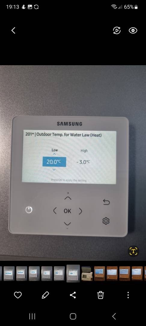

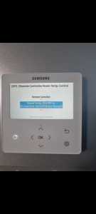

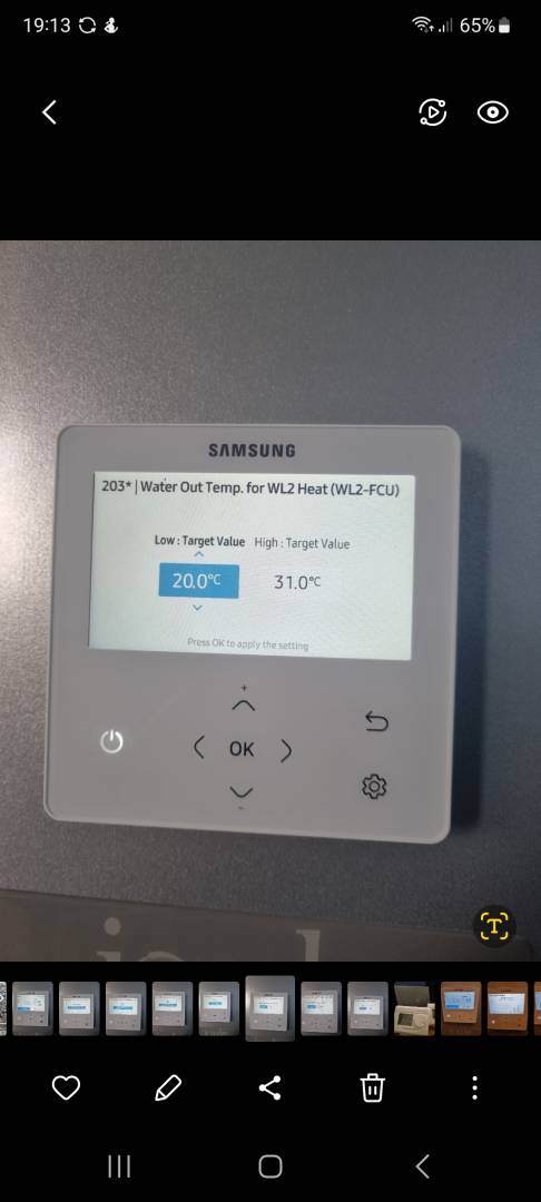

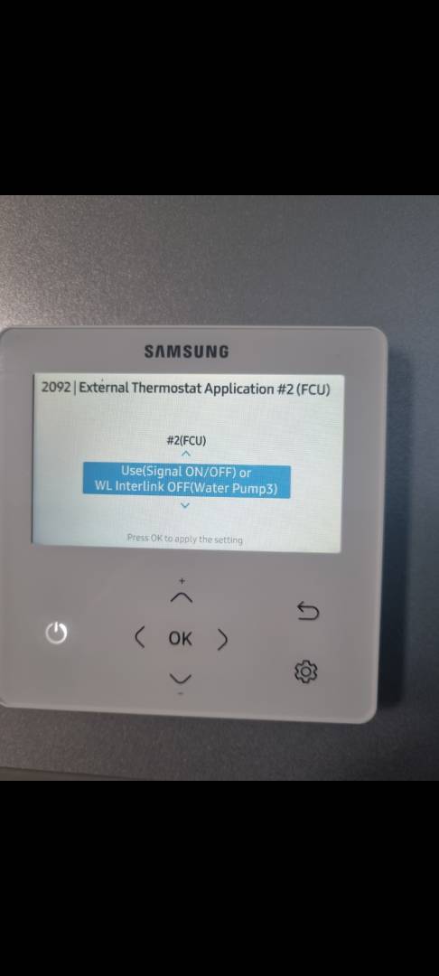

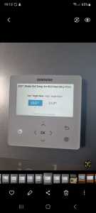

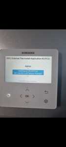

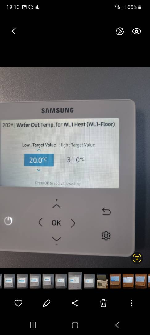

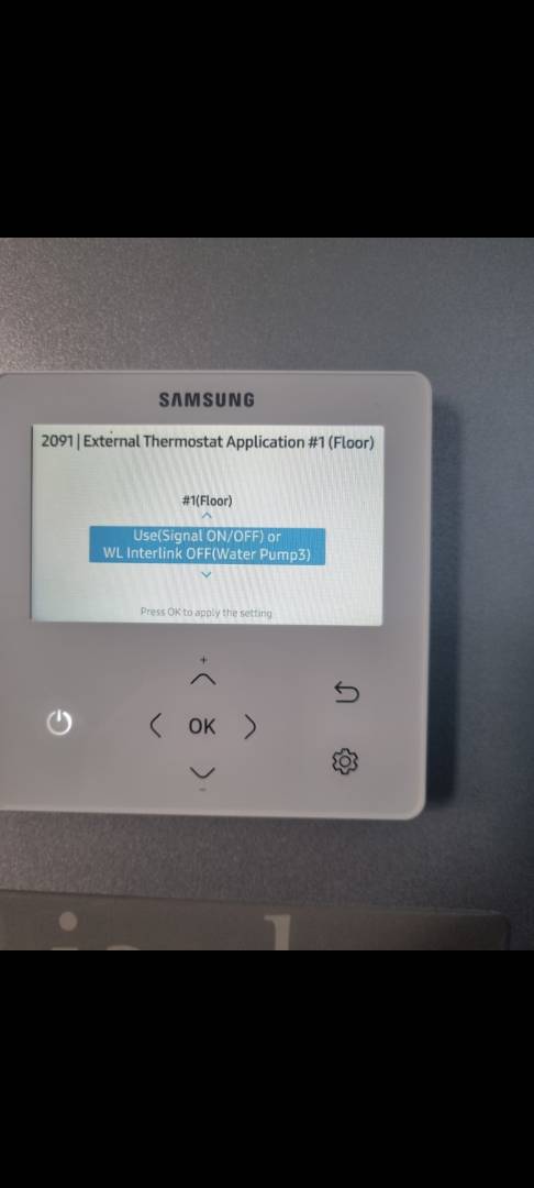

Pics of the screen set up of water law.
Not sure if the set up with "floor" is correct. Whether it should be  FCU instead?
Also running -2 on the home screen which I'm led to believe is a short cut to adjusting a water law setting. Assuming the 31?

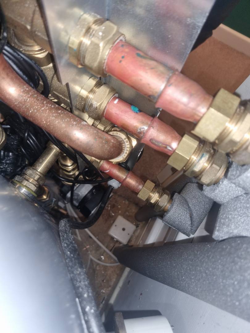

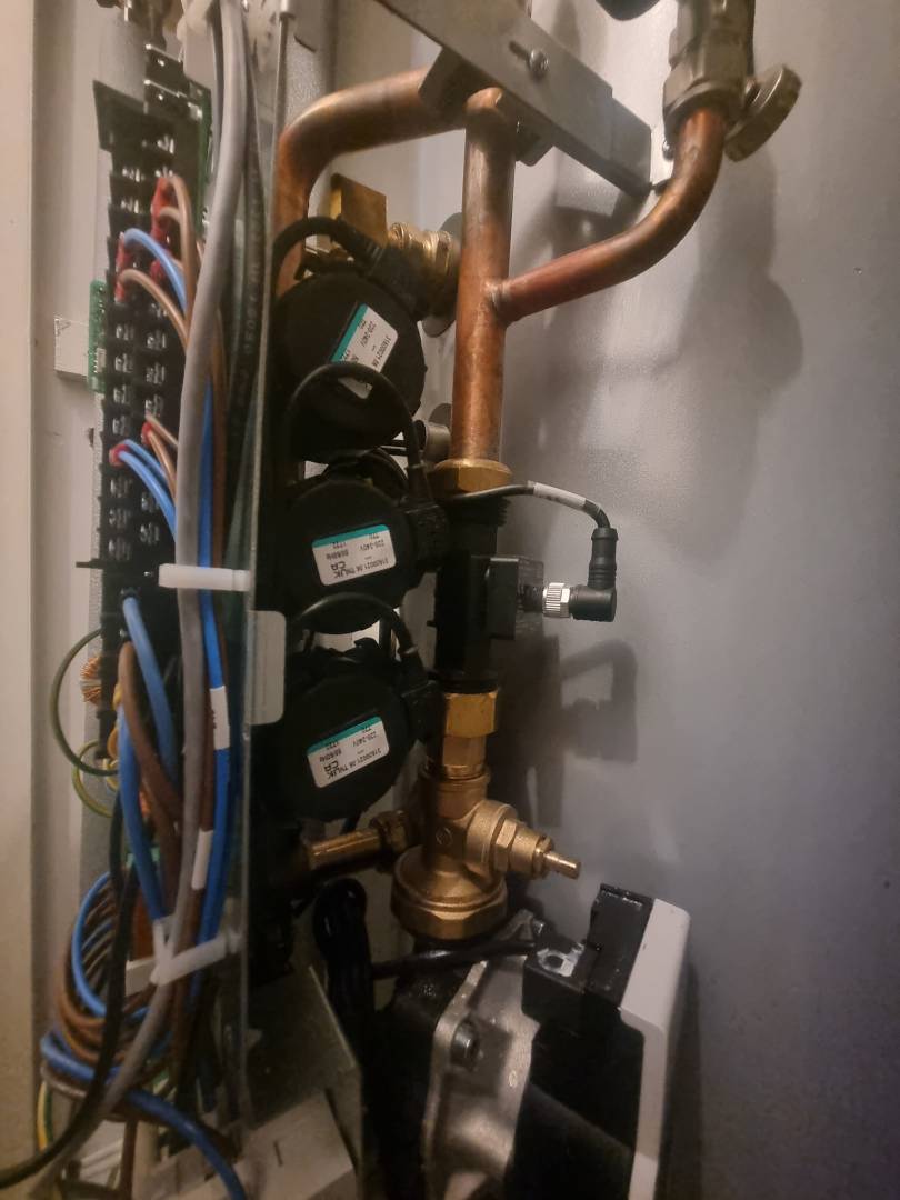

Posted by: @derek-m
@hughf

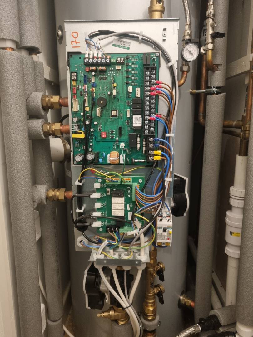

Yes, I've seen all the different diagrams in the manuals, but it doesn't tell one which is correct. Also I don't see the point in having two pumps to do the job that one pump should be able to do.
I’d go with the one from the Jule installation manual, as it’s a Jule cylinder/heatpump package. Now that we’ve seen some more photo’s you can clearly see that the hydraulics match what is shown I their manual exactly.

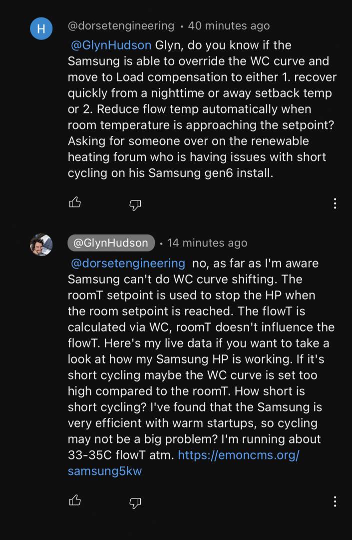

I have a lot of time for Glyn Hudson over on YouTube who has just DIYd his 5kW Samsung install and has documented it with a decent video. From the comments I’ve been having with his, he says that the Samsung will still use WC when the wired controller is used as for measuring room temperature. I’ve asked him if the controller will also support load compensation and reduce the flow temperature when the room is approaching the target temp. Inversely, increasing the flow temp to recover quickly from a nighttime or away/holiday mode setback temperature.
He uses a single pump (with PWM control) on his setup but his primary pipe work is short.
