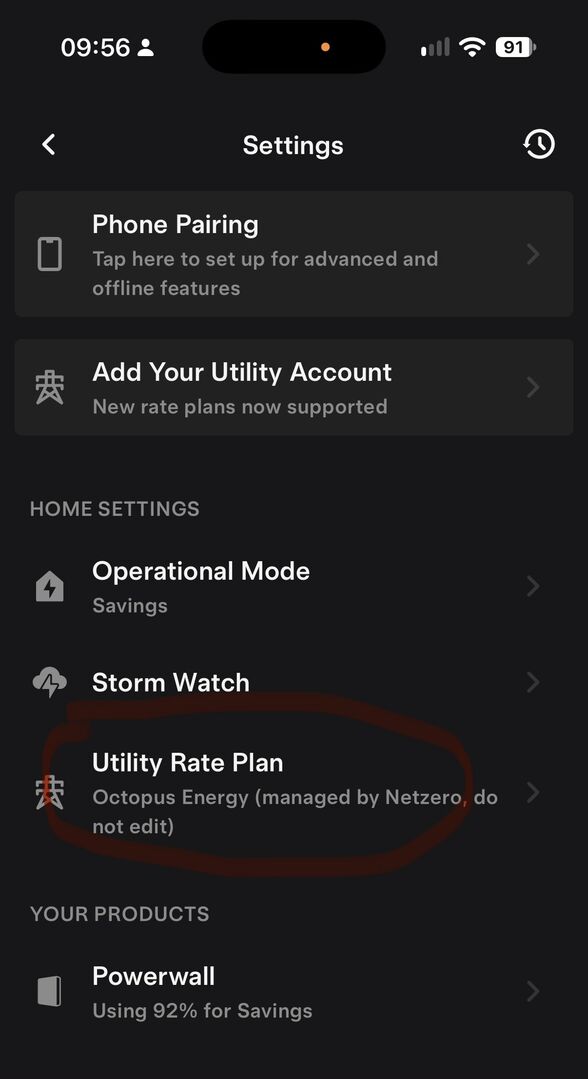

Off topic (slightly) - i use the basic Net Zero app and the Octopus  ‘Utility rate plan’ is managed by the app. Is there any advantage/disadvantage using the PW2 app to connect to, and manage, the rate plan?

Posted by: @davesoa
PW2 app
What do you mean by this PW2 app exactly?
Or do you mean advantages/disadvantages of NetZero managing the rate plan?

@f1p See attachment.

@davesoa Are you using NetZero as a newish user; when I first installed it, the full facility was available - then they introduced the idea of a trial period after which the Pro version was obtained but monthly/yearly subscription. It looks as though your PW2 is still under control of NetZero at present. Regards, Toodles.

@davesoa That’s impossible, the basic net zero plan does not include any automations. You can enter the rates but it won’t be acting upon the information you include.
(@davesoa)
Posts: 97
@toodles I’ve been using the free version for some years and my PW2 utility rate is under it’s control. I’ve not had any problems but was idly wondering whether to let Tesla control the rate plan and whether that conferred any advantage/disadvantage.

I am 100% sure that net zero is not controlling your PW2. It is monitoring the performance but it is not acting upon it in any way, unless your are paying a subscription that you are not aware of.
(@davesoa)
Posts: 97
I am 100% sure you are correct. What Net Zero seemed to be doing was setting the IOG schedule and rates using the Octopus API. I’ve now used the Tesla app to connect my PW2 directly to my Octopus account and Net Zero is grumbling that my API has gone awry.
