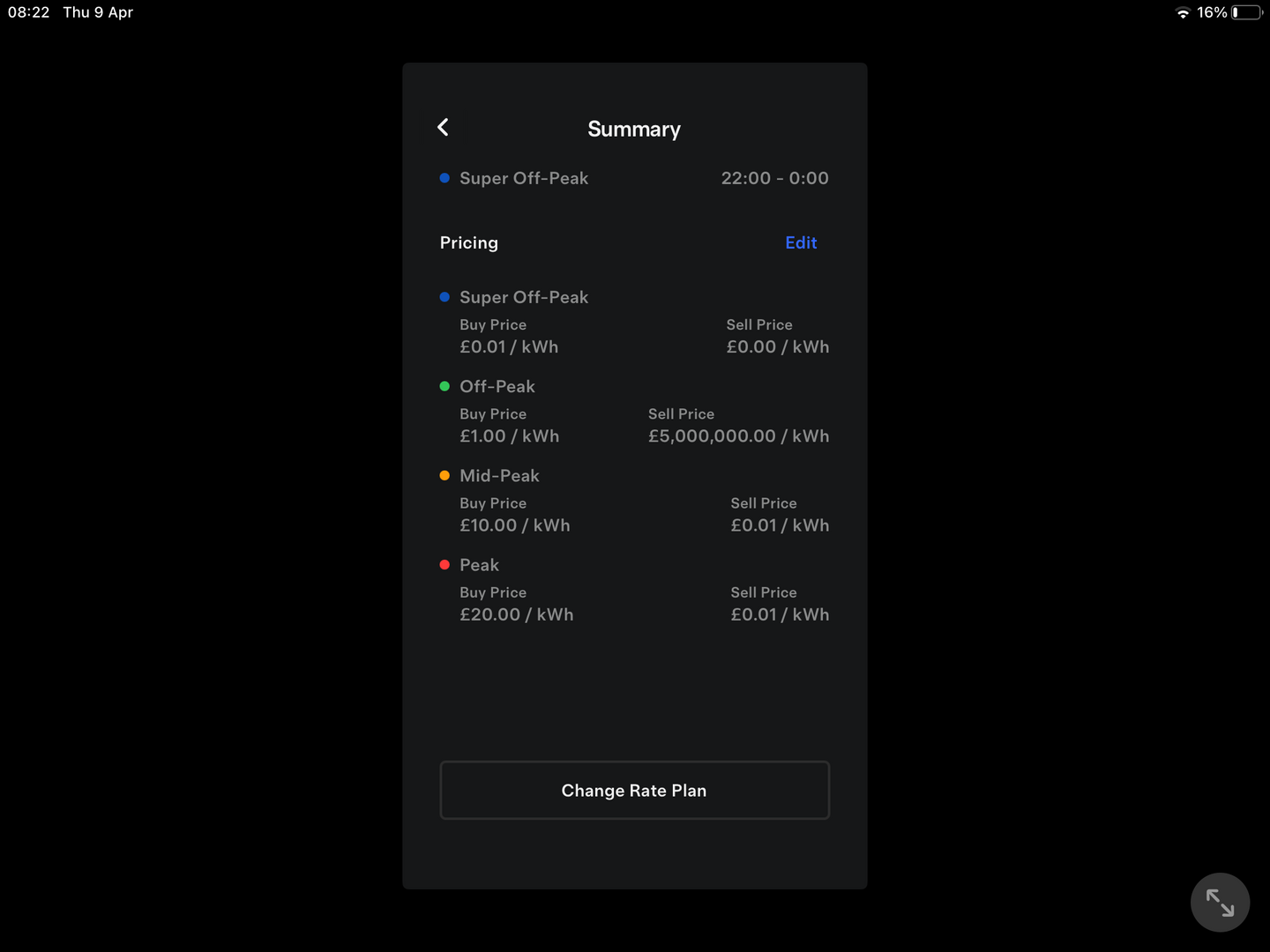

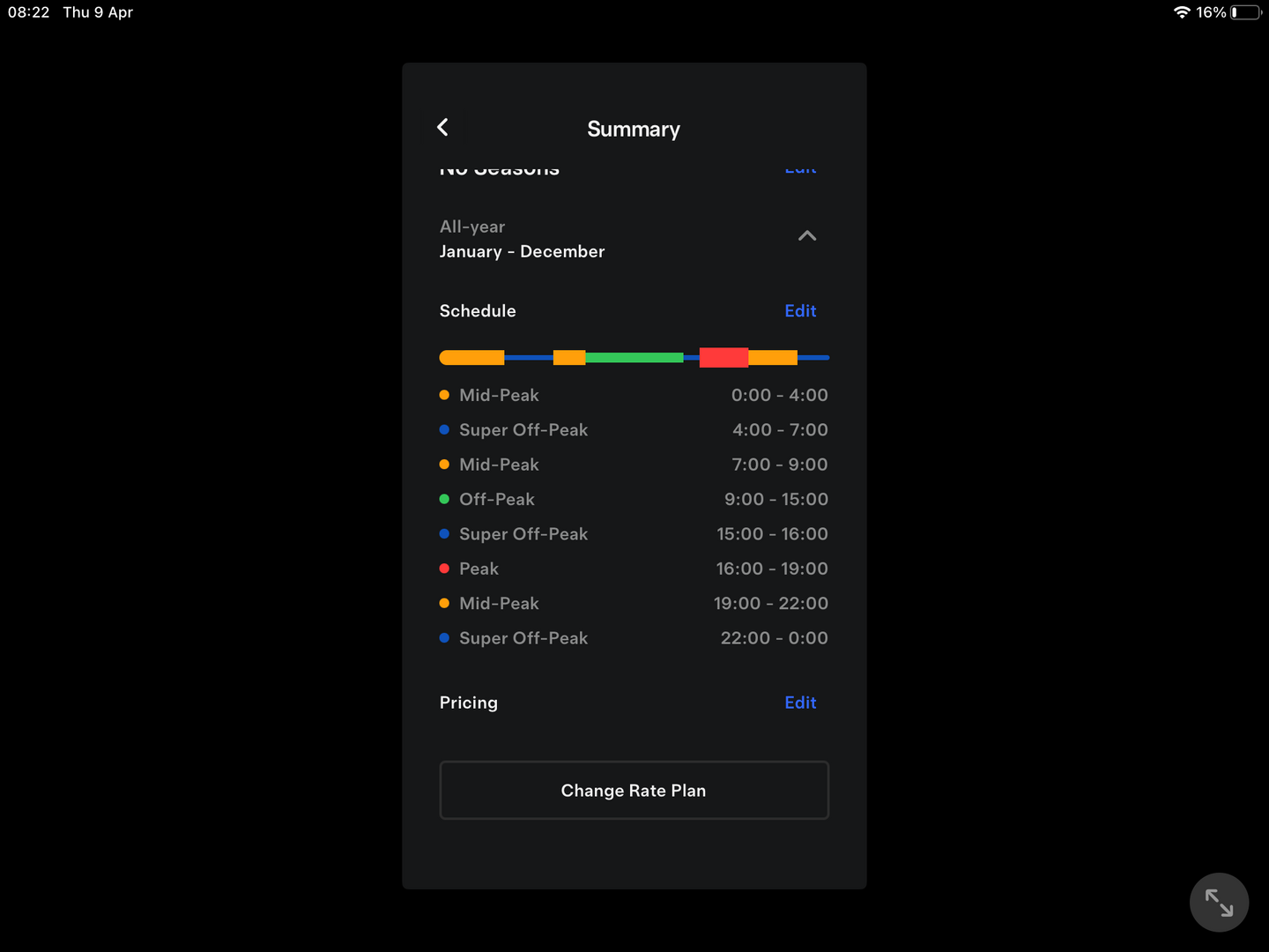

@papahuhu My loadings in the tariff are not that extreme at present but I thought that they might suffice to tell Tesla my intentions and desires. Just for fun, I might add a few noughts and reduce other figures anyway. Regards, Toodles.

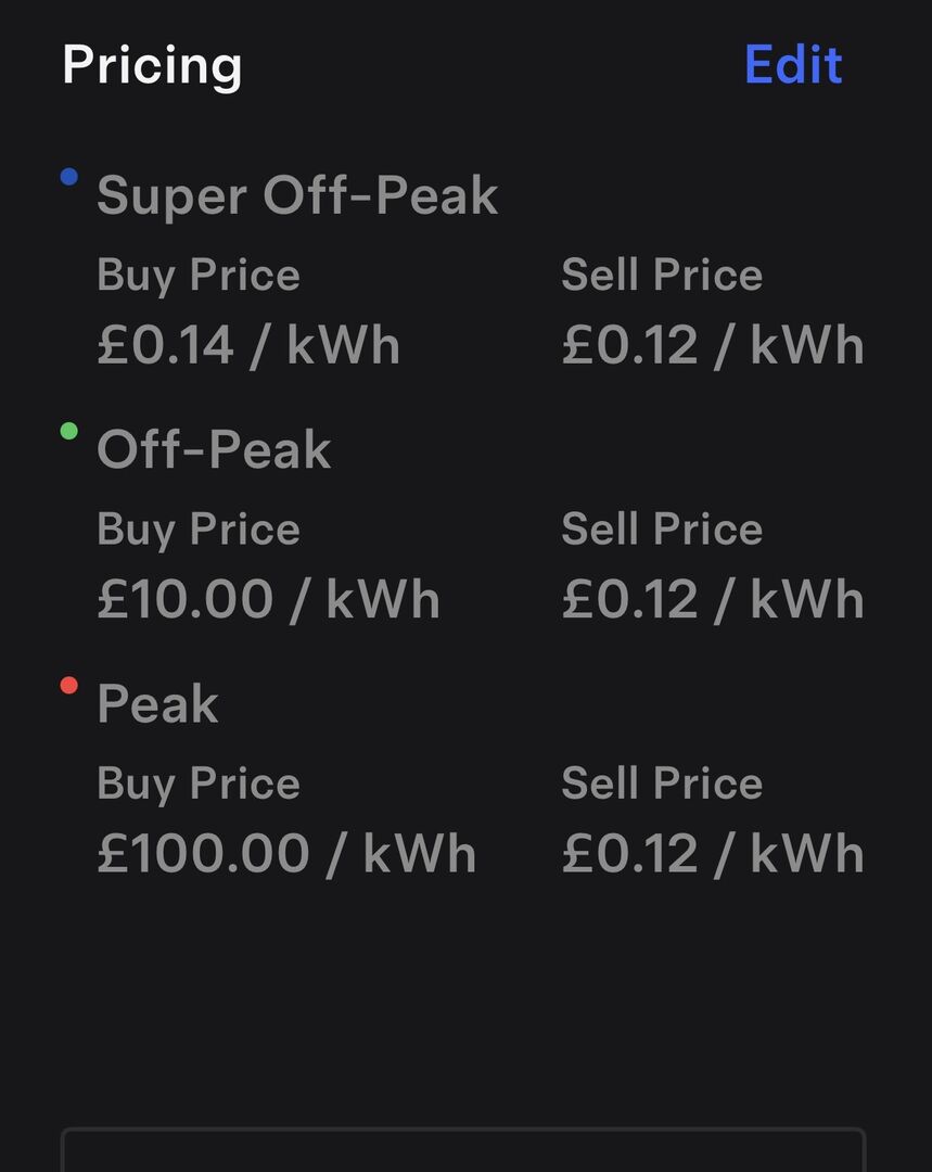

In previous firmware versions you could not effectively set the sell price higher than the buy price - the software just ignores it and sets both values the same. So if you want to force export during a session, set both sell and buy prices the same at the high level you desire.

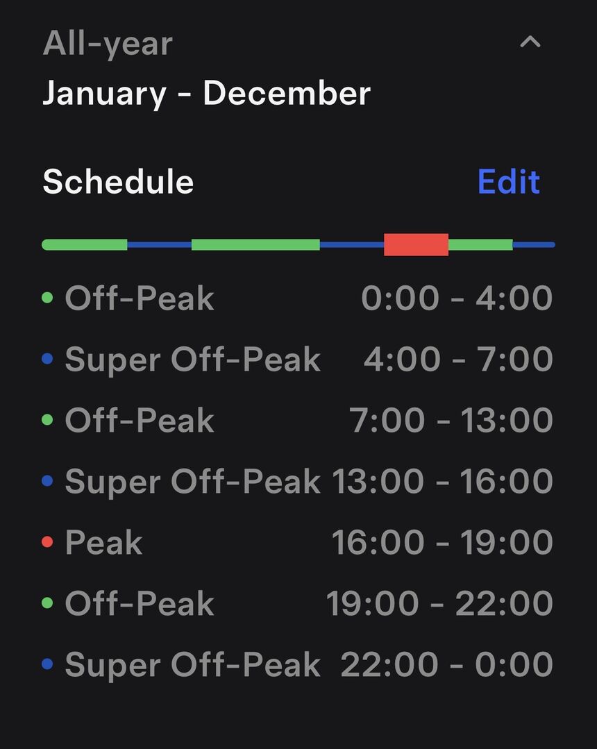

When deciding whether to charge from the grid, the AI will need a week or two of data to learn your consumption patterns. This is probably OK as small amounts of heating phase in slowly over autumn. If it's not doing what you want, you can force it to grid charge by increasing the reserve in the cheap rate slot and then reducing it again, or you can again you could change the buy/sell price to 0p for those sessions. That works well for the 10pm-midnight and 4-7am slots, but be careful setting a 0p sell price during the 1-4pm slot as that will have unforeseen consequences as it will export solar during the morning rather than charging the battery to reserve space for solar in the afternoon when you've told it that it has zero value.
Last winter I only used peak and off-peak settings, priced at 15p (off-peak) and £2.00 (peak) which worked well - IOW don't you dare import from the grid other than during off-peak times. Sell was priced at 15p for all periods. This worked perfectly once the system had learnt my usage.
