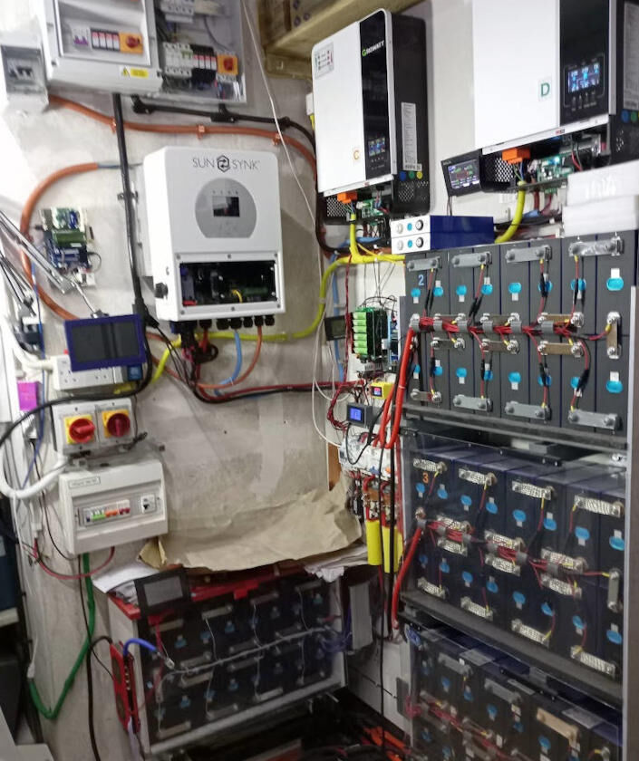

I've got hands-on experience of installing hybrid off-grid battery storage, and I'm currently part-way through switching from three Growatt inverters
to three Sunsynk 5kW units.

Posted by: @lostandconfusedWith your sunsynk, will you be doing whole of house via the UPS or splitting the consumer unit for just essentials?
I have options to do both.
I'm an innovator, for which the storage battery facility is one of the 'tools' in development work.
I currently have four mains Consumer Units, but that's because I sometimes need to change my mind as to which circuits are supplied from where.
There are also two solar-panel 'switching and protection' boards,
and a number of low-voltage distribution 'boards'. 😎
Ie I run a significant number of home devices directly from the 52v battery, without power going back through the inverters.
Since you're particularly interested in off-grid operation, then I can directly address that issue...
... but preferably over on the other topic, where the fundamentals of storage batteries are already discussed!
