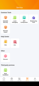

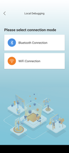

Thanks. That now makes sense. Connecting to the datalogger via Bluetooth was very straightforward and does indeed refresh more regularly. It seems a bit random, sometimes 10 seconds, sometimes around 30 seconds.I found out how to connect via Bluetooth using the local debugging option.
Now there is an option to connect also via WiFi, which would be perfect as I don't want to go to the garage each time.
Unfortunately I can't get it to work, it keeps saying the password is incorrect. I have tried the WiFi password and the Solis Cloud password, but neither work.
Have you tried this way, if so what password was it?

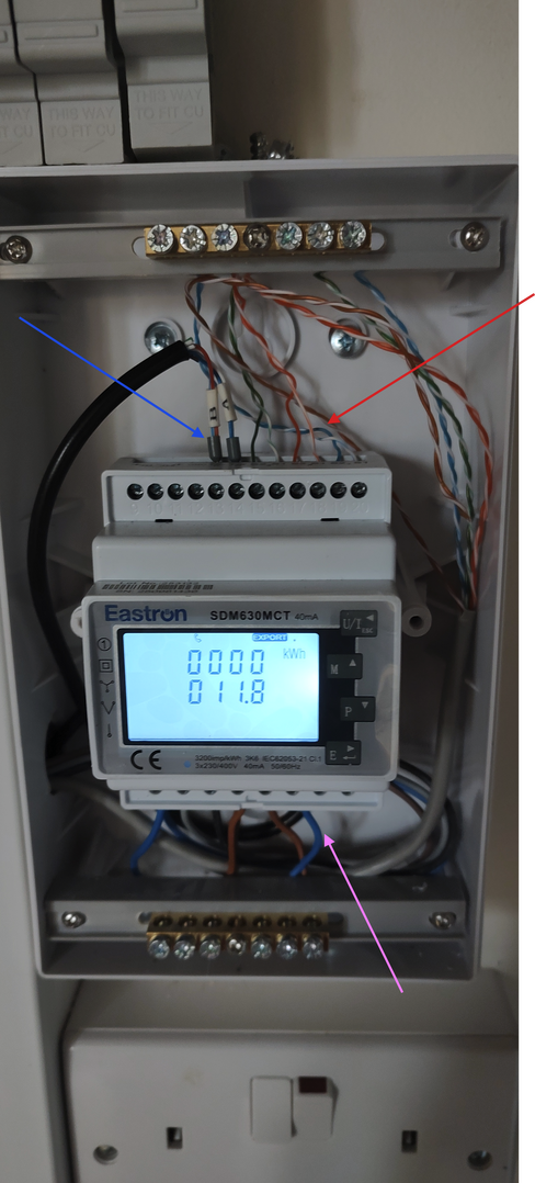

@transparent This is the meter.
The CT's are connected in the top, red arrow, extended with Cat 5 cable. The blue arrow points to two connections labelled A&B and the other end of these cables are connected into the inverter on an RJ45 plug. The connections at the bottom with the pink arrow connect to the main board here
7,8,9 is the meter. 10,11,12 is the Inverter connection to the board.
The issuse with the inverter importing was because the meter was connected to 6,7,8. There was an RCBO in 9 and I guess he didn't notice or it didn't occure to him that this would mix up the phases of the CT's
The Eastron SDM630 range is known to me.
I have one here, but it's still in the box awaiting a monitoring trial which has yet to start.
Your meter wiring looks correct.
1-4 are wired Neutral, L3, L2, L1 which is right
You have an Auxiliary Supply for the meter itself on terminal 5 & 6.
Terminal 13 & 14 are the RS485 port.
Wires A & B are the correct way around, and should be connected to the inverter using a twisted pair cable.
The other six connection to the CTs look good to me.

I'm not certain whether the second photo is taken after the electricians latest visit or not.

The second photo was after his visit on Friday. It is taken before the front cover was put back on and the notes written in pencil are normally covered up by the front cover. The front cover has the labels on to indentify each breaker. The 3phase breakers, higher one is connected to the meter and the lower one is the inverter. The RCBO that was in 9 will eventually have a myenergi eddi connected to it that will be powering the immersion heater, only added as I already have the eddi from the last house. This is now in the highest position. It might be moved again.

The cable extending the CT's is probably about 10 mtrs long, possibly a bit longer but I haven't checked. Is there a limit for extending them? I assume it is a lot further than 10 mtrs

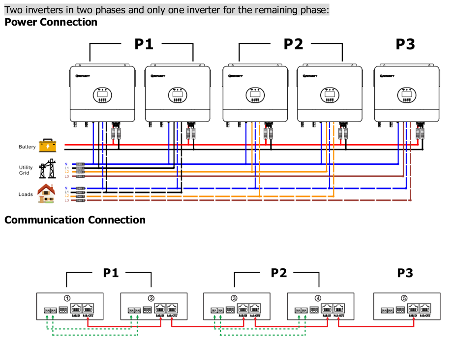

FWIW many 3ph storage battery installations are actually built using banks of three single-phase units.
Those won't have any issues with delivering different currents to the phases they supply,
and the system design offers greater flexibility and resilience.
Eg a building might have five inverters, with two each supplying a phase, whilst the 5th unit supplies the third phase on its own.
Here's just such an arrangement from the Growatt SPF6000ES installation manual

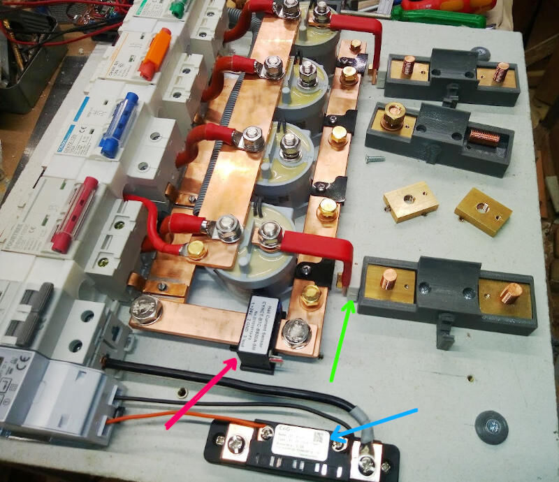

The most common 'standard' for clamps and shunts which read current is that their max output (at whatever current they're intended for) is 75mV.
You can either buy 'cheaply' from suppliers on AliExpress,
or get a certified 'industry level' current sensor from Sonnency in Germany.
The picture below shows a Battery Combiner Board being built with three different approaches to current measurement.
The red arrow points to a Hall Effect current sensor by Sonnency.
As you'd expect, the level of technical support from Sonnency is excellent!
