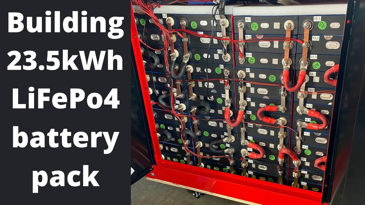

If I had the time I would build a 16 prismatic cells (280ah) in series to give a 51.2v nominal battery c11.5kw at 80% depth of discharge.
YouTubeOpen on YouTube
(@batalto)
Posts: 1092
@mattengineer all those batteries are basically exactly that. Just in a nice box with a BMS attached. Pretty sure Seplos actually sell a DIY kit
seplos.com
262m2 house in Hampshire
