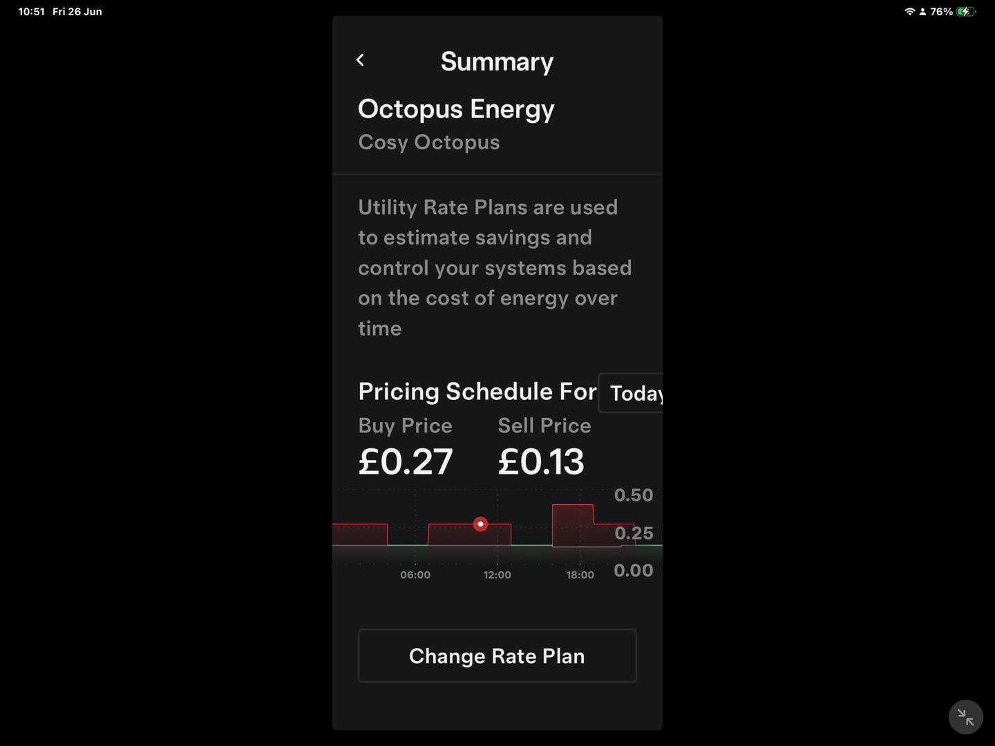

@old_scientist The plot thickens… As you will see, I accepted the Octopus Cosy part of the setup.
IMG 1662
IMG 1663
But change rate plan assumes a blanket change! I note that you mention the Octopus logon business - I did this and now realise that perhaps ALL SETTINGS need to be manual rather than the OE’s default Cosy import. I will have to see if it will allow manual control of Import and Export - Ho HUM. Toodles.

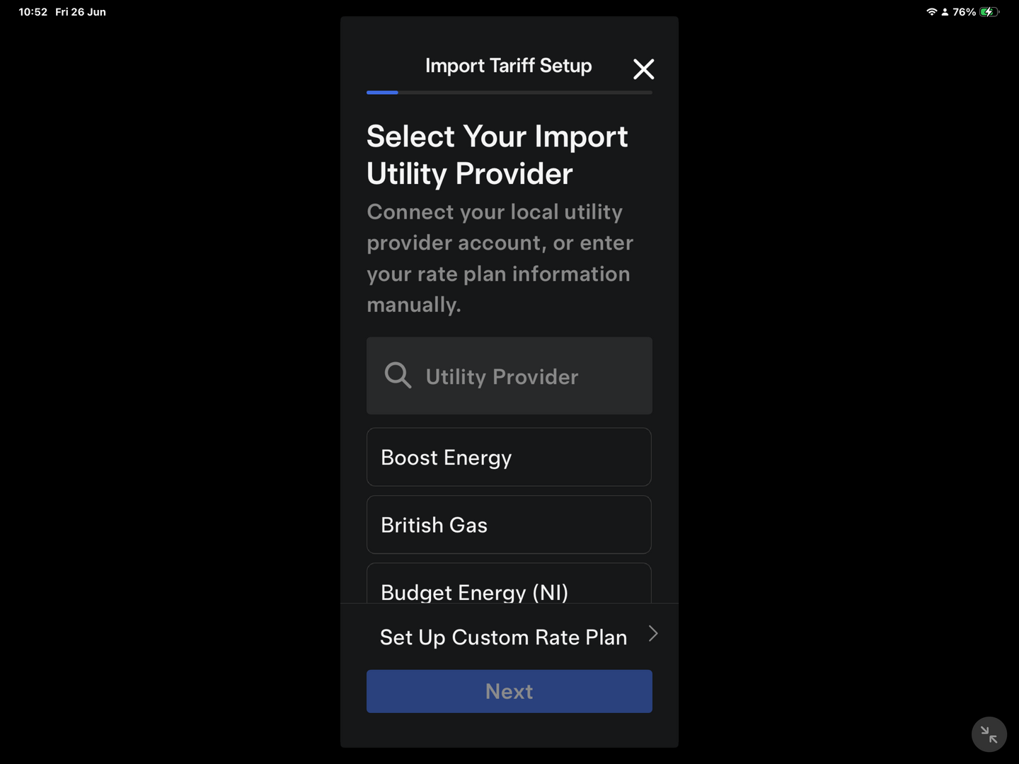

Yes, you will need to switch back to manual setup of your ToU tariff.
In the right hand image, select Set Up Custom Rate Plan at the bottom - that should allow you to set up an old fashioned rate plan manually, like you had 12 months ago.
I called mine something like Octopus Cosy Manual so I knew it was something I'd set up manually 🙂

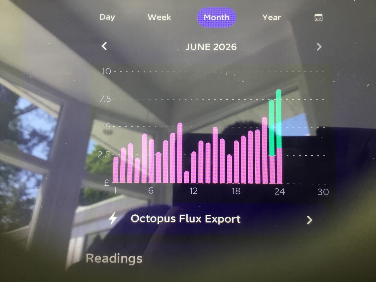

Thought I’d try and persuade you that youd likely be so much better off with flux than cosy. This screenshot is cosy vs flux, the last 2 days on flux.
