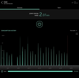

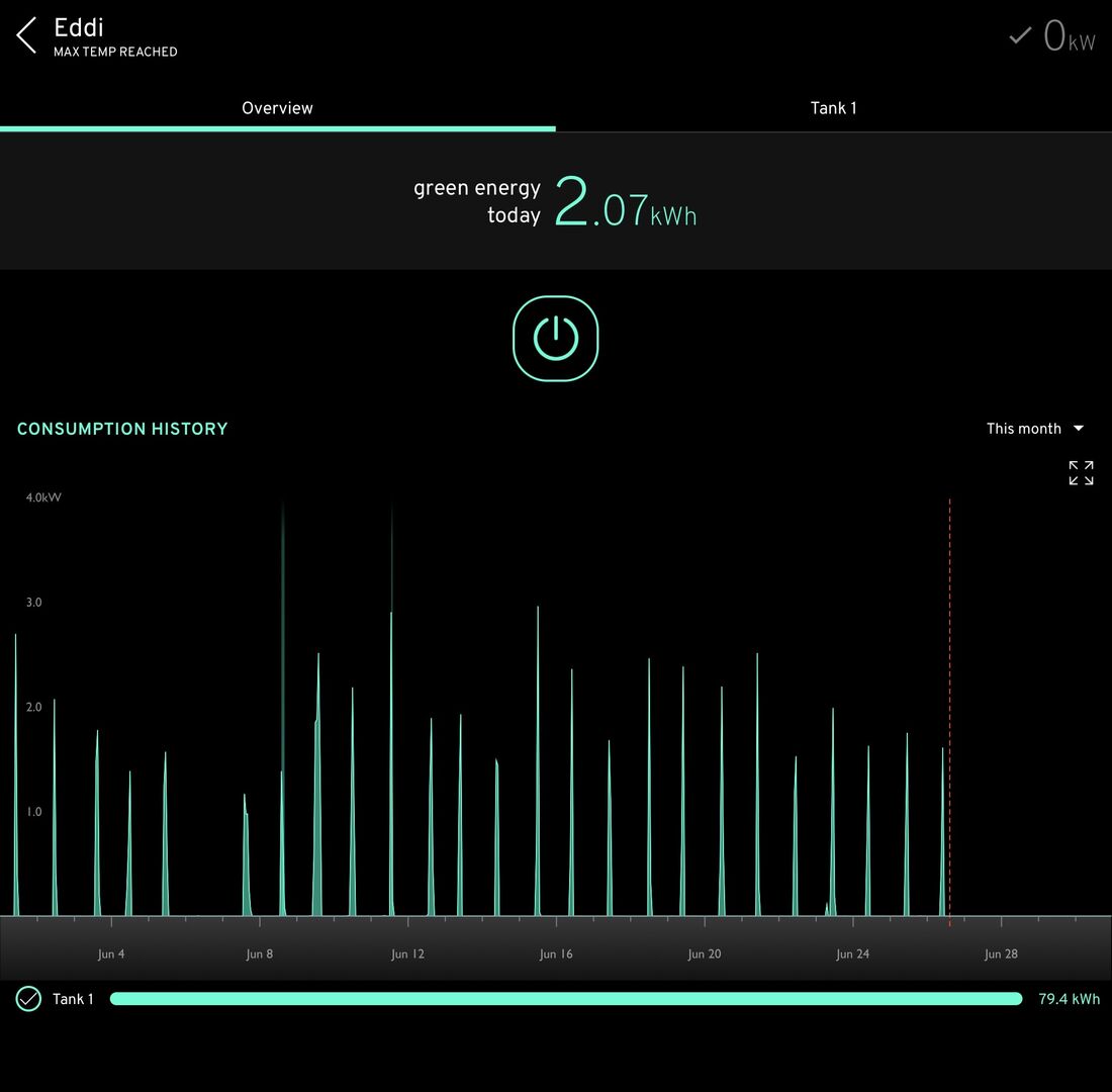

@papahuhu Here is a screen grab from Myenergi’s Eddi controller; all of the power supplied to the Sunamp Thermino is via the app whether solar or from grid. The daily consumption for each day so far this month. At this time of year, solar energy provides all power and as this would otherwise realise 12 pence per kWh. with Outgoing Fixed export, I reckon it is very reasonable. Regards, Toodles.

(@papahuhu)
Honorable Member Member
Posts: 444
@toodles Difficult to tell at this low resolution, but looks like the heating cycle is about 3-4 hours and about 2-3kW, so I make it very approx about 10kWh, which seems much more in line with what I’d have expected. Even at 10kwh at an heating efficiency of about 90% that’s still good going, you must be quite frugal with the hot water.

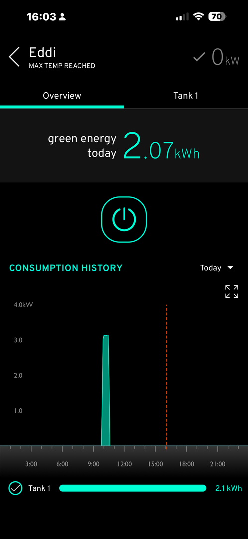

Posts: 3091
@papahuhu As you say, the resolution is there to tax you! No, the total consumption for a heating session is what is indicated by the spikes - not the kW. Therefore in any one day, the Eddi will charge the Sunamp at varying rates up to (if available from the solar source) 3 kW, normally this will complete in about an hour or a little over. If the full 3 kW is available without a halt, then charging is taking less than an hour per day at present. Please see higher res. indication for today.
IMG 6942
Regards, Toodles.
(@papahuhu)
Posts: 444
At 2 kWh its either breaking the physics of sensible heat or you are a tyrant and forcing your good lady wife to shower with a thimble of tepid water!
Even if it were at 100% efficiency, 2kwh of power will raise the temp of 100kg of water by 17C. I can’t find an actual manufacturers efficiency figure anywhere, they are very coy about it.
Posts: 3091
@papahuhu Well all I can say is, it works! Neither of us spend that long in the shower and under present heat wave conditions, I find I turn the shower temperature down somewhat as this is more comfortable. I then have to remember to turn the mixer valve back up for the boss - or else! A little over 2 kWh for a day’s hot water requirements does seem very reasonable but it is genuine! Regards, Toodles.
