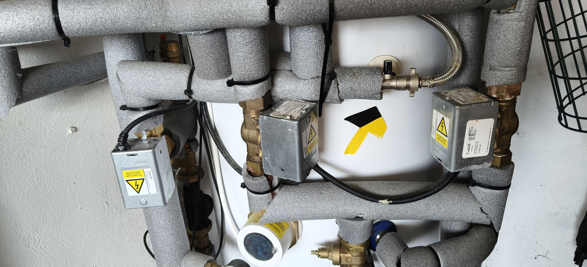

In your case, converting it to a single zone sounds like a reasonable approach. If you're keeping both motorised valves, the goal is for them to operate together whenever there's a call for heat. I wouldn't recommend simply linking the demand wires without first checking the wiring centre, as the valve end switches and boiler interlock still need to operate correctly. A quick photo of the wiring centre and the make of the zone valves would make it much easier to suggest the best approach.

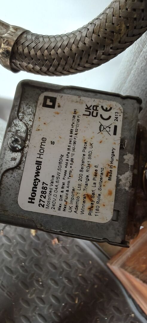

Autumn's here & I'm still think of ditching the second zone. Joining the two demands together - they are both simple 240V lines.
You asked for more detail - the valves are simple Honeywell ones. I suppose I could lock zone two open🤔.
Or lock them both open by turning up the stats, then adjust the weather compensation curve and if  necessary balance to get the house temperature right at the lowest flow temp.  No wiring needed.

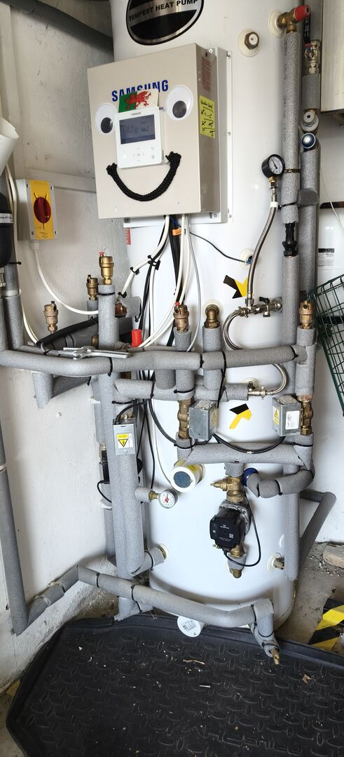

Posts: 3522
Your energy: 109 kWh
@profzarkov - where is that Tempest water cylinder situated?
Is it within the heated envelope of the house?
... or in a porch, garage, basement?
Am I allowed to comment on the insulation which isn't covering all those nice, shiny brass bits? 😉

Troy is in the garage & yes I could cover more of it up!
