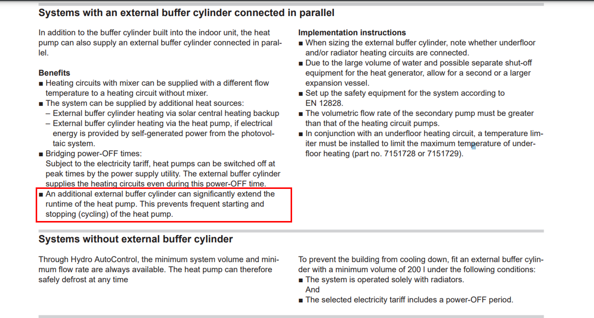

@damon Whilst we are waxing lyrical about Viessmann as a pinnacle of heat pump system design, attached is an extract from their manual. They state that a buffer tank can "significantly" improve the operation of their heat pump. It should be connected "in parallel" to the heat pump i.e. 2 port connection. Furthermore, it should be used on radiator only systems with TOU tariffs? Somebody please explain. So, buffer tanks are good, are they?

@heatgeek this is for an additional buffer vessel, used for separation.
it can prolong run times but imo you would be better with a volumiser rather than a buffer, in certain situations buffers can work.
low load, hot water being sized for rather than heat demand,
large property and low occupancy for example, it all comes down to design and what the system requirements are for that client and property.
no panacea

Posted by: @heatgeek
Yes it would prolong run times as they say to use a minimum of 200L.  Great if you have space, but then you have lots of radiators so should have lots of water capacity anyway. They also say if running on radiators only.
