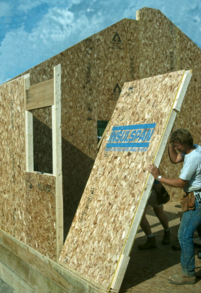

Would you consider using SIP (Structural Insulated Panel) technology which can be lifted into place by crane in 2-days flat?
