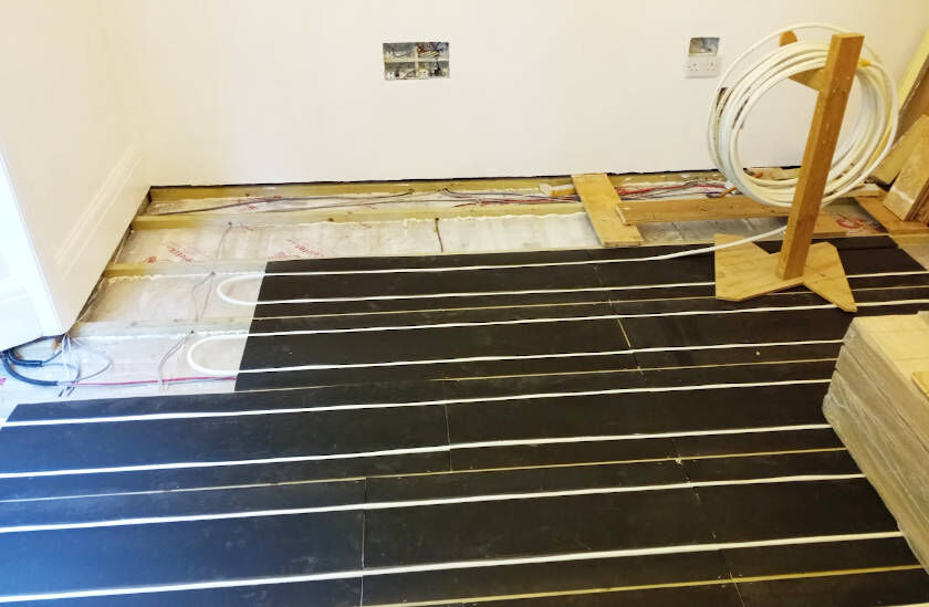

I do think there's an advantage in you having suspended floors in the bungalow.
Unlike solid concrete floors, you can readily add insulation between joists and underfloor heating (UFH) pipes.
I've been doing just that in my own (1937) house, one room at a time.
In my case the original joists also required replacing because they were reclaimed broad-gauge railway sleepers!
UFH is more efficient than radiators, and is better at heating the human body.
Both of those factors may be relevant to your situation.
Floor22Md
The photo shows 16mm UFH pipe being laid into aluminium heat-spreader plates.
The far-end wall (without the skirting board) is a false timber-framed wall.
It adds 30mm insulation and blocks off an old fireplace.
Please ask if you'd like to see any more photos of this work. I have loads!

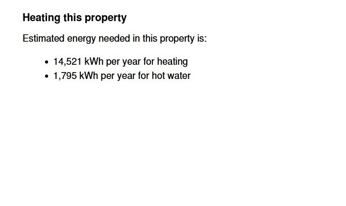

So assuming 45p per liter and 7 kWh per liter thats about 19,000 kWh per year for heating. Does that match with your EPC, it should state it as mine does in the image.Note my projected heating total is not much lower than yours at 14500 kWh and I have a 5kW heat pump (albeit nicer weather 🙂 )
The electricity bill does seem high but that could be due to clothes drying?
I agree with James that the EPC grading does seem low after the suggested improvements, I dont have any EWI on my house, much as I would love to.
