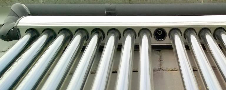

But I'm puzzled by your description of the failure.
I too have a thermal solar system. As I installed it myself, I have a pretty good knowledge of how the component parts fit together.
Damage to one or more of the evacuated tubes should have no effect on the circulation water.
The water/glycol mix passes through a copper manifold.
The 'hot end' of each vacuum tube slots into a pocket on that manifold.
Manifold
There is no connection between the circulating water and the vacuum tubes themselves.
I can remove tubes for cleaning and re-insert them into the manifold without draining the system.
To maintain thermal conductivity, I apply more heat-transfer compound to the end of the copper collection-rod before re-installing.
VacuumTubeB
If you had a loss of pressure, from where did the fluid leak?
Photo?

@transparent I went on the roof tonight to clear all the glass up. I think due to the manifold's age (25+ years), it has developed a leak filling the tube with water hence it exploded with the steam pressure. I pulled out the copper tongue briefly from the manifold and water / glycol rushed out which as we know it should not. It would require a new manifold and tubes which is not worth the hassle as it only produces 4 to 5 months of the year. Will decommission and look to replace with PV's, at least they produce something all year round plus they will be more versatile with no servicing as I have enough to maintain in my house! Lol
