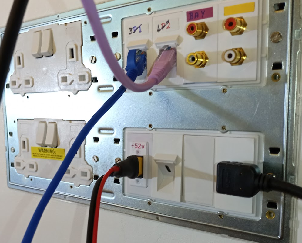

@transparent - as a matter of interest whats 52V for? It sounds close to being like a telephone system (usually 48V) but I presume not!

Posted by: @jamespaas a matter of interest whats 52V for?
I'll admit that a 52v wall outlet is rare.
I presently have just two, and both are in my study/workshop area.
Most of my household DC wiring is for fixed apparatus... usually a DC-DC converter to 24v or 12v.
But there are occasions when I want to connect a more complex arrangement of devices which operate at different voltages,
and/or where the arrangement isn't permanent, such as a desk which can be moved.
For those situations I've installed a high-current wall socket, such as those commonly used by drone operators and RC model enthusiasts.
My choice of 'standard' is an XT60, for which Amass is the main manufacturer.
This is the basic arrangement:
All of these component parts are obtainable online, either in the UK, or at a much cheaper price from AliExpress.
My 52v wall outlet is created from a 50x25mm modular blanking plate.
