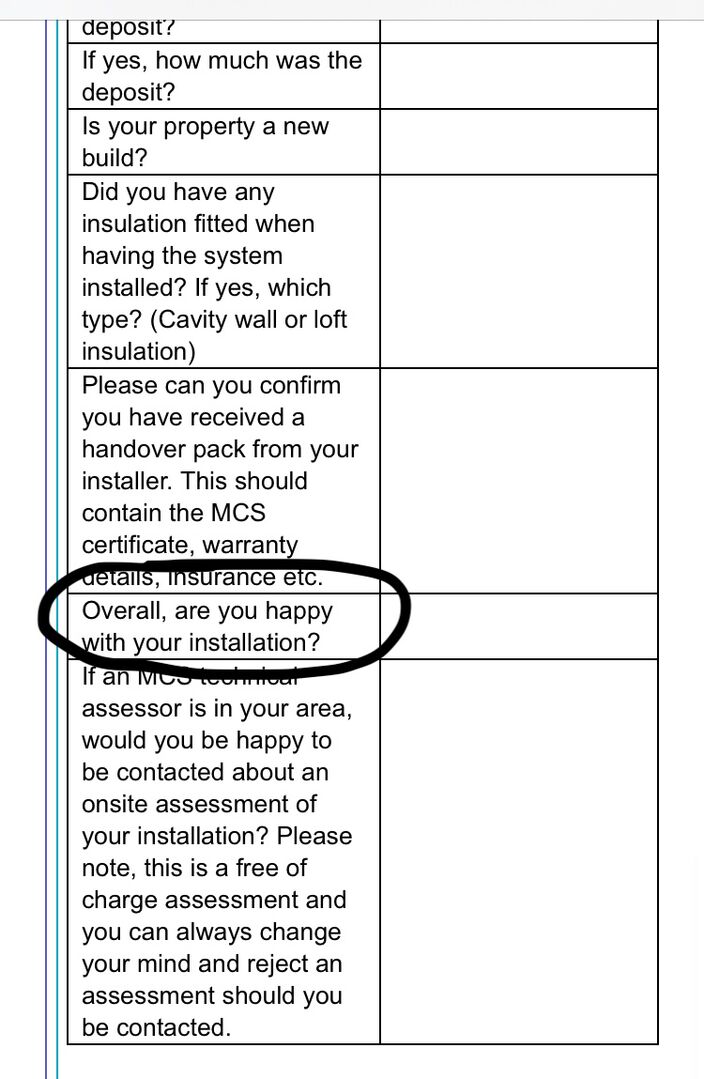

@majordennisbloodnok, that 95% satisfaction figure comes from MCS and is based on their post-installation homeowner survey. The key issue is when and how it’s collected, and I have pointed this out to Ian Rippen. The survey usually lands just days after the install, when the system hasn’t been through a winter, hasn’t been stress-tested and the homeowner’s main concern is whether the house is warm that week (which cold be mid July) and whether the installers were polite and tidied up.
The question itself is along the lines of “were you satisfied with your heat pump installation?”, which most people will answer yes unless something truly spectacular went wrong like the installer leaving rubble everywhere or parking a van on the lawn. At that stage, very few homeowners have any idea whether the system is correctly sized, efficiently commissioned or about to saddle them with eye-watering bills once the temperature drops.
So the 95% figure says far more about short-term customer experience than long-term system performance. Taken at face value, it’s deeply misleading and presenting it as proof that “everything’s fine” is, frankly, a farce. Classic MCS BS

I agree entirely about the extent to which surveys can be manipulated by design, @deltona. The best counter, though, is a survey painting a different picture, but with a sensible methodology that’s out in the open for scrutiny. The awkward bit, of course, is laying your hands on such a beast.
I dug through my documents and finally found the questionnaire - to be honest there isn't a hell of a lot to manipulate here 🤣
I shudder what the 5% you said no went through!
MCS Post Installation Question   Are you happy
