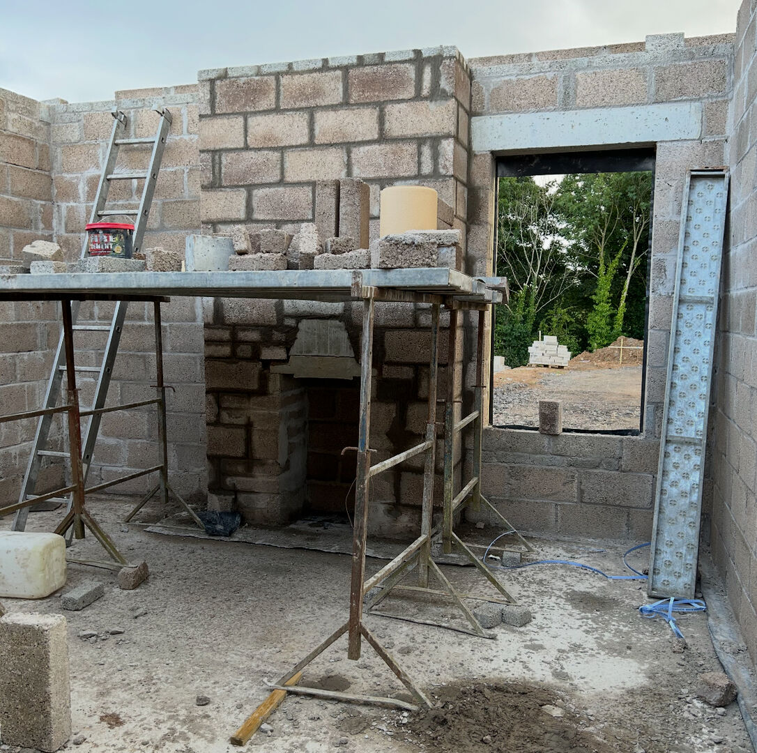

IMG 4494
@johnmo
Very good point.
It’s something I should have given a lot more consideration.
I will contact my contractor to ask if it’s possible at this stage to change the open fire in this room to a sealed stove. I know it has been built to accommodate a fireback and has the lintel etc in place.

Posted by: @gcon45
When looking at room sealed stoves, you need to ensure primary and secondary air are taken from outside - some only take primary air from outside and secondary from the room.
Room sealed should only need a 100mm hole through the wall and this is then ducted to stove.

Posted by: @gcon45
Yeah the flue for the fire will be sealed up for about 360 days of the year with a draught excluder.
It’s a traditional house so it’s in keeping with the style.
I’d imagine the fire will only ever be actually lit around Christmas time.
We have a cassette style inset stove, much more efficient than an open fire, which is less than 5kW so doesn’t require any deliberate ventilation. It is a Stovax but the model isn’t important. With the door closed there was no discernible air leakage when we had the whole house leakage measured.
Our MVHR endures ample ventilation if we were nervous about CO with the fire lit. The fire really is just a visitors on special occasions usage and when we feel like it, since the novelty wore off a while ago back.
So your multi-fuel stove will have no leakage to speak of leaving only the open fireplace extra to a well insulated modern house. Our 200m2 50s house needs a 7kW heat pump which keeps us nicely warm. You are unlikely to to need much above 12kW!

(@judith)
Prominent Member Member
Posts: 555
@johnmo  no external air supply, just the room air. We do have CO detectors and never had any alarms.
But the measured flow on the MVHR system vent provides enough air flow
(@Anonymous 5011)
Posts: 562
Posted by: @judith
Braver person than me. No way I would go down that route.
