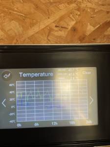

Short cycles would typically be defined as cycles that are less than 20 mins in operation (imho)... A defrost cycle once per hour in these temps seems reasonable.
When you go into settings, what is in there, nothing called 'curve'? Please post up a photo.
(@myanthony)
Eminent Member Member
Posts: 33
Yes when I go into curve it’s pic I posted previously.
524B98CD 8014 41B7 A9DF 12435EA85986

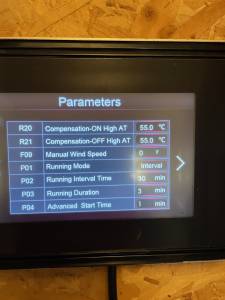

@myanthony Sorry, my mistake. The weather compensation is accessed from within the password protected engineer menu, page 22 - the password is '0022'
The weather compensation is called 'Ambient temp compensation'
Post up a picture of that screen if you can.
(@myanthony)
Posts: 33
@hughf

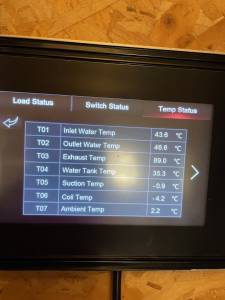

Thanks for all your help. There is no graph all that mentions ambient temp is
1896D5F1 8815 438E B8EE 1FEBB9387F66
55E4B9C8 D5C9 4E9D B337 E7583F463CBE
(@hughf)
Honorable Member Member
Posts: 489
@myanthony Get on the phone to warmflow, ask them how you can access the weather compensation menu as your unit doesn't match the manuals.
