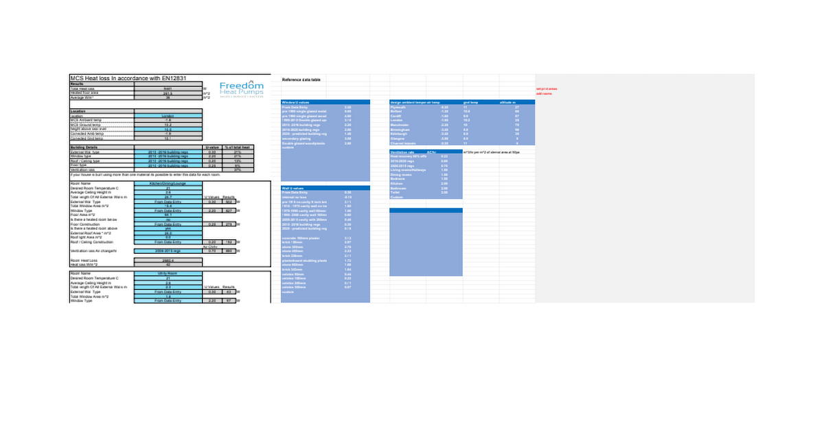

I would suggest you try speaking to the installers. I got a tool sent to me developed by Freedom Heat Pumps which works through all the steps you might need to take. I've converted it into a google sheet you can download and use at your leisure. Its not my tool, so might have issues. However Freedom are a pretty big company, so anything they developed is probably pretty legit for your use case.
https://docs.google.com/spreadsheets/d/1HAGXEC7WOhjsmXFf8Noh9CUvafc8E-DvoKn96zehmYc/edit?usp=sharing
@bobbt9866 That might be. I've not interacted with Freedom at all, I just got sent it when I was getting quoted by one of the companies as an FYI. Seems pretty good and I had to go through the room by room and correct a number of assumptions the survey made about wall insulation. For instance they assumed our upstairs as double glazed, when it is triple. However that isn't an option, so they I had to manually find the U value and edit it myself. Overall though the figures tally with the quoted ASHP and give me a good idea of running costs I can work with
Posted by: @bobbt9866That sheet/programme was probably created by Graham Hendra who certainly knows his stuff.
Always worth finding blogs done by Graham for their information.
