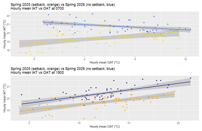

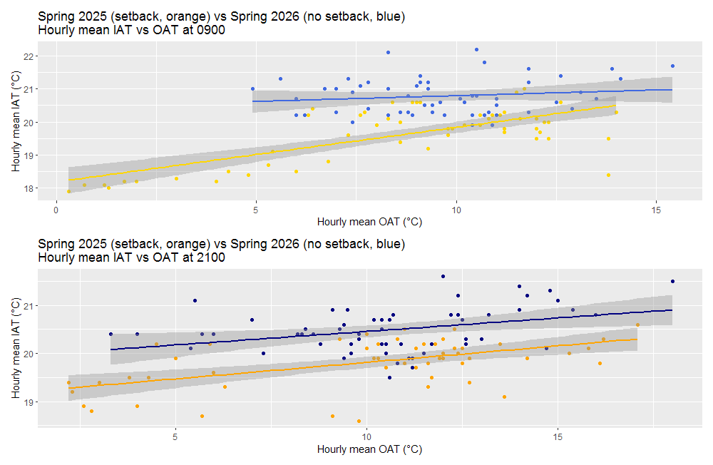

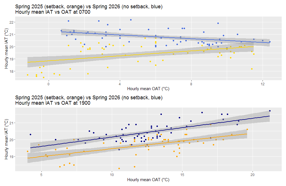

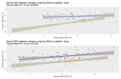

Might this be explained by the lower OAT end of the WCC being a bit too high? With no setback, the heat pump more than keeps up, but with the setback, it has to do the recovery, and the lower the OAT. the more recovery it has to do, and so the lower the IAT at 0700.
Yes, also the higher OAT end is possibly a smidge high too.
Posted by: @cathoderay
This fits with what I have just said, the WCC, which was the same for both 2025 and 2026, although the lower IATs in 2025 will have triggered more auto-adaption, needs to be lower at the lower OAT end with no setback running. But if the same WCC is used with setback running, then the low OAT 0700 IATs will almost certainly go lower. Another example of how tricky the 'natural' experiments can be!
Also that experiments often need repetition to incorporate discoveries.
I noticed them as well, they are clearly outliers, and I meant to look into them, suspecting they may be from a few days at the very end of April 2026 when the heating was off but I forgot to delete the relevant rows. I have now done that, and the outliers have disappeared, see below.
I also did a double take on the subplot titles, 0700 and 0900 on the same one above the other plot???? Then I realised you had very neatly copied and pasted together the two morning plots...
Thanks, that would explain them!
