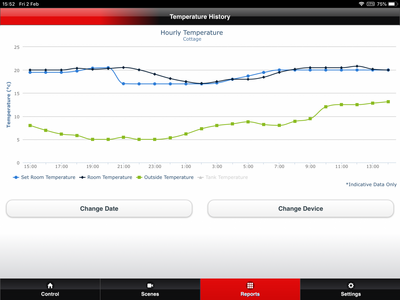

I have to say that, for my part your statement is not true. Here is one sentence from my definition of our setup.-
“In summary the purpose of these trials have been to see if there are any energy savings in having an automated setback over a 7 hour period of night time, while still guaranteeing a comfortable room temperature of 20.5c between the hours of 8.00am (or earlier) and 10.30pm.“
The post then goes on to clarify the schedule used to ensure the IAT guarantees a minimum room temp of 20.5c.-
“We are operating a setback from daytime 21c back to 17c between the hours of 9pm and 4am. The ramp up in the morning starts at 4am and is achieved in 1c increments with 1.5 hours between each 1c rise taking our set temperature up to 20c. The incremental rises are designed to keep the Auto Adaptive controller operating at a minimal output so that the feedback loop doesn’t see large temperature rise targets. The 21c room temp is achieved by Auto Adaptive always over running the target by half or one degC.”
the page I’ve posted at the top of this post is from my topic “Creative trials in night time setbacks….”
perhaps you haddent read it but the top of page 2 describes definitions and performance conditions of the trial which needed to meet in order to be a valid trial. There were over 3 months of trials and 5 trials of 24 hour operation with a spread of outside air temperatures to give a range of results.
It was a period of intense testing which I think proved a distinct trend in addition to some new insights which were not expected.
there are example graphs of 24 hour operation showing the guaranteed room temperatures during the trials. Furthermore there is an explanation of graduated temperature rises so that the HP did not race off in high flow temps. And how this could be scheduled for automation.
