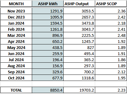

@drei just a small detail on your table posted on the 24th. scop is seasonal coefficient of performance so you need a year  of data . What you are showing generally is monthly COP.
Your figures are pretty bad, less than 2.0 in April is shocking

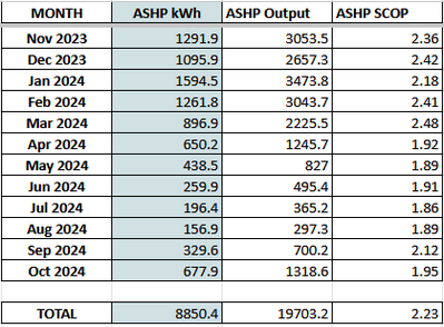

That's why you can just add one full year, and it will come to 2.23, so far you can just look at the total numbers over almost 2 years:
37835.6 / 16522.3 = 2.29
Or here:
Annual SCOP Data
Just to be clear, the SCOP is the total data, not an average of the monthly ones.

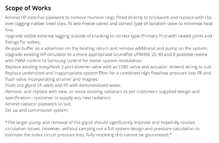

In addition, this is Heat Geek Elite quote I received for my remedial work:

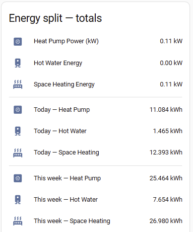

Here is the data so far, but even this is not 100% as my net sometimes drops. Still, gives an idea. I tend to have the hot water running on ECO mode, only goes to STANDARD about midday, back to ECO and then it switches OFF at 20:30 until 5:00.

@drei - there is definitely something not right, notwithstanding if your 'net sometimes drops' (not sure what happens when a person's net drops - I presume you mean internet connection), because in the day and the week data the totals are less than the sum of the parts. How are you actually getting the data?

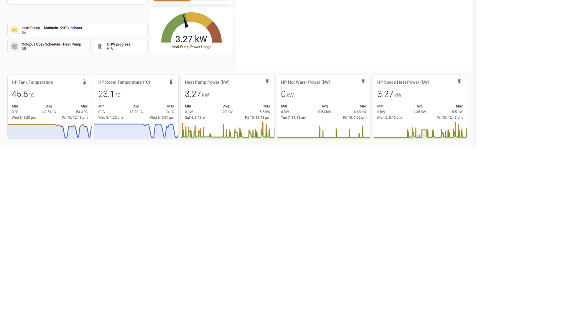

I am using Home Assistant's utility meters, so they add up the relevant data based on live readings, to make up the daily, weekly, monthly and yearly data. These will eventually get better, as right now it doesn't have a whole month worth of data, or a year.
The handicap is that it is still using the Heat Pump sensors, as it is connected to it via WiFi, and every now and then, Samsung wants HA to re-authenticate, which will cause a gap in the data, unless I can pick it up straight away.
For example, these are my readings right now over the last 168 hours:
Not 100% accurate, but it is better than we I had, and I made the power level to a maximum of 8kW and red over 6kW, no idea if the HP would even reach that but, if it is a 12kW Heat Pump, does it mean that it can draw 12kW electricity at maximum usage?
No. 12kW is obviously the maximum heating capacity (at certain conditions, dependent on manufacturer) but the actual maximum consumption will be much lower than that. I think our 12kW max power input is around 5kW. You can get the figures for yours from the technical bulletin, data sheet etc.
