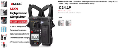

If the heatpump manufacturers app does not show it, you could use a ct clamp or a smart switch. Most provide that information via their app.

Given that the peak power has to be determined in order to size the generator or inverter (and the number of queries I read here, where the users cannot find it like from the manufacturers app), a CT clamp or a smart circuit relay still seems to be a cheap and effective way to assess it.
