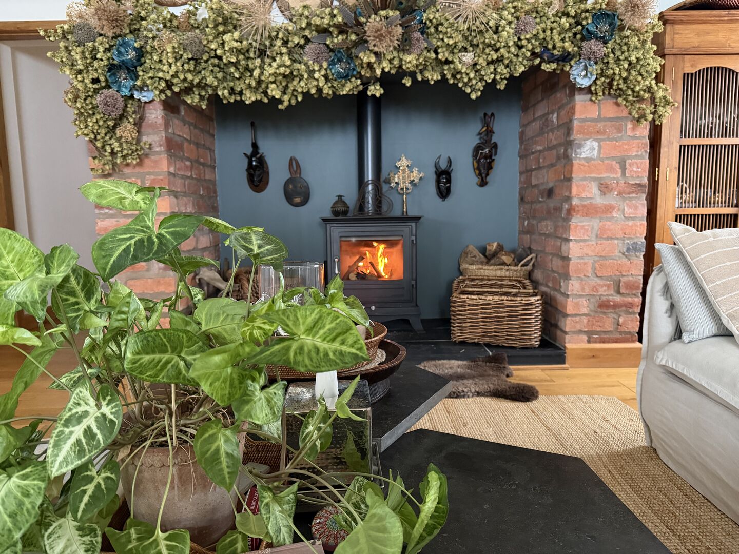

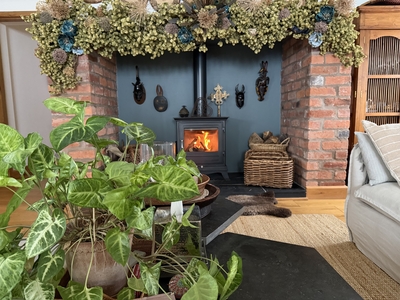

Right on topic, Storm Goretti has done its thing and we’ve been without power since last night… looks like we’ll be lucky to have power restored by 9pm tonight according to text messages from the DNO.
The fires are on and downstairs is heating up.

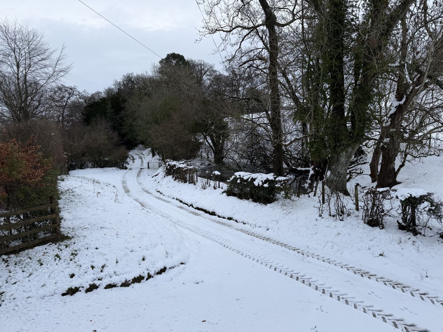

I do find it odd how ‘fragile’ the electricity infrastructure is in the UK. We ended up having about 25cm of snow last night, and no overly strong winds, so I’m really surprised that huge areas around us are without power.

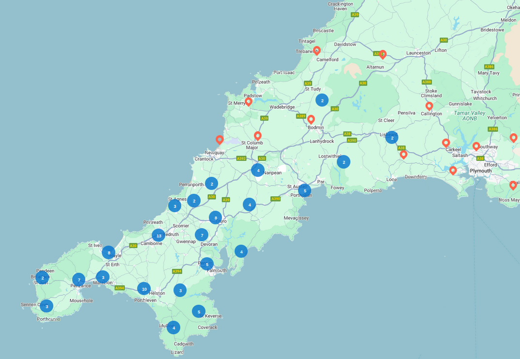

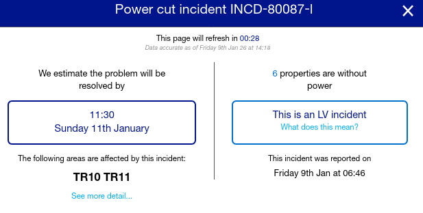

Here's the Power Cut map from Cornwall at 23:00 last night
NGED outages 2026 01 08 23 06 03

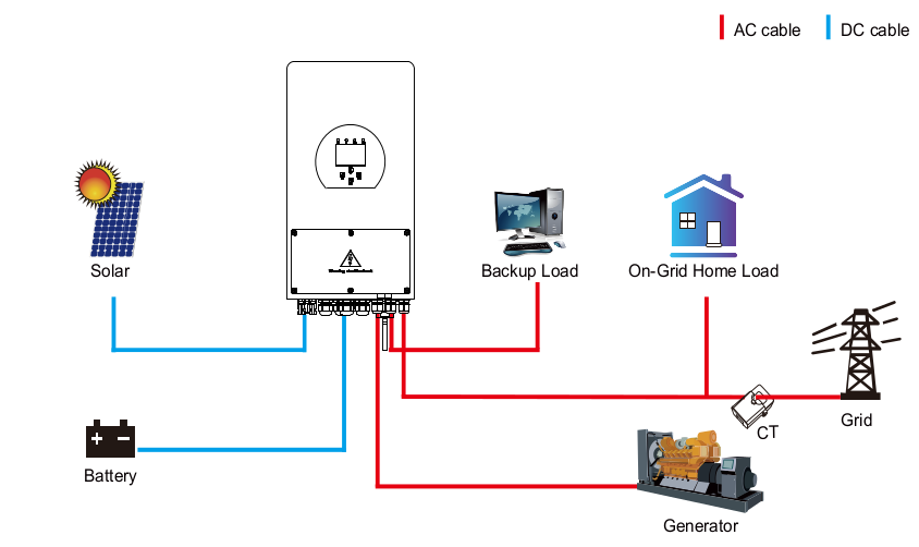

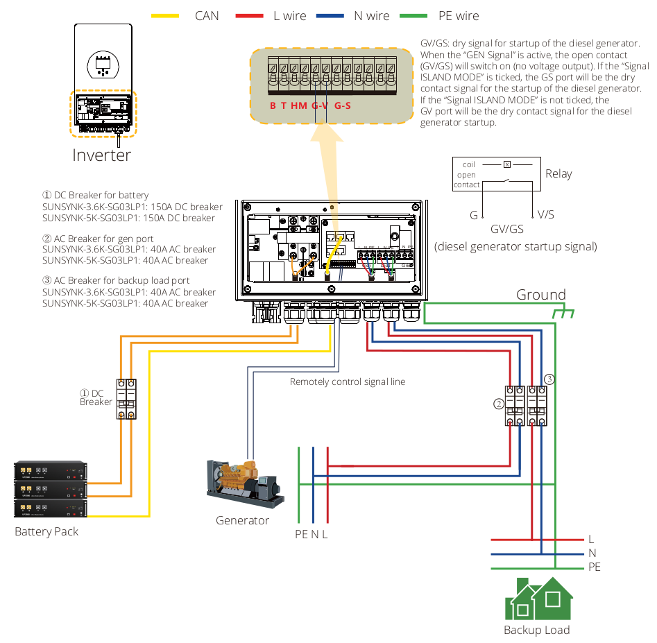

The best strategy for adding a (diesel) generator is to connect it to a dedicated input on a hybrid storage inverter.
That allows it to run in its 'sweet spot' for efficiency whilst re-charging a battery.
And the inverter will switch it off when the stored energy reaches a threshold which you configure.
Here's the notes from the Sunsynk inverter, describing how the relay contacts can be wired to
start and stop the generator automatically.

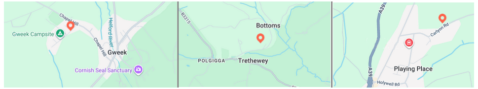

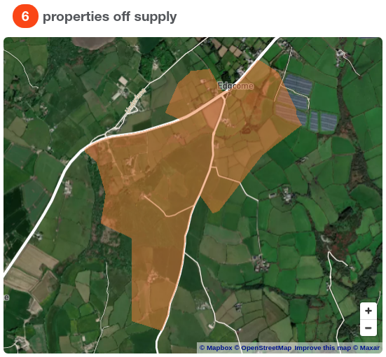

Here in the West Country we get notification of when they expect power to be restored in an affected area:
Currently we have NGED engineers working in Cornwall from elsewhere in the UK.
That can cause confusion when they don't understand our place names:
