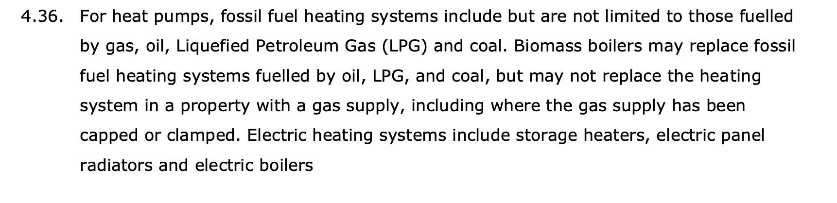

It would appear that the the Ofgem Property Owner Guidance is unambiguous on this. For heat pumps, fossil fuel heating systems eligible under the BUS include but are not limited to those fuelled by gas, oil, LPG and coal. Coal back boilers are explicitly listed. Whoever told you otherwise was misinformed. You can verify this directly in the Ofgem guidance document here.
Screenshot 2026 05 28 at 20.52.29
And the official Ofgem application voucher form itself lists coal as one of the fuel types being replaced. Link here.
