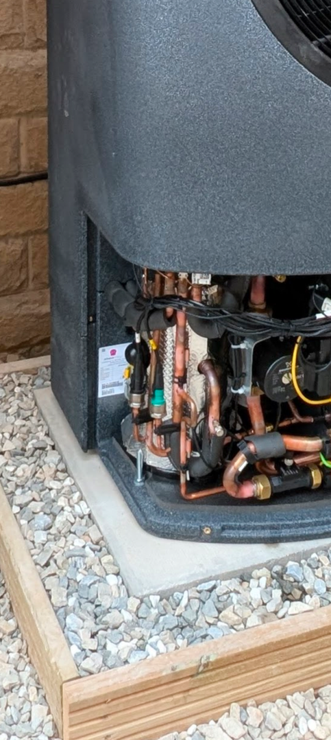

(@swwils)
Posts: 97
@editor here is mine during install. Don't under estimate the groundwork though, it's alot of gravel. Through bolted to slab. They also now have the leg kit available but I don't think it's a default.

@swwils so is the noise reverberations or the fan?

(@swwils)
Posts: 97
@editor on my case, I think it's the fan causing a reverberation.
In other people's, it could be the pump (unlikely) or the compressor causing a reverberation. Or maybe a combination of them all. It's such a weird thing to experience, even very tiny shifts the the source frequency can make a huge difference.
In some others, it may well be the fan itself causing an airborne noise, but id like to think that's almost impossible, unless something is broken.
So it's tricky to work out and quite unlucky if your effected.
