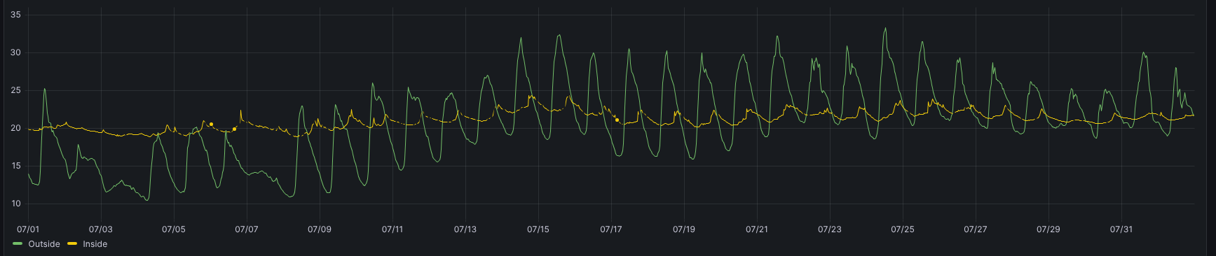

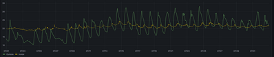

I do the same thing with my heat pump and my underfloor radiant. I did not need it this year since summer wasn't hot, but this is a graph from 2025:
Screenshot 2025 08 02 15 55 52
Green line is outside temperature, in the shades.Yellow line is inside temperature. Both temperature sensors are Ruuvi tags.
Water circulated in the floor between 15C and 18C depending on the humidity.
