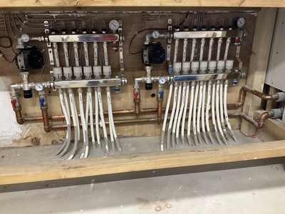

I'm having trouble attaching a photo of my UFH manifolds. Basically I have 2 manifolds with 7 loops on one and 6 loops on the other. There is a pump for each manifold.
IMG 0824
I'm going to write my initial observations of the manifolds photo, not just for Mike's benefit, but so that others can follow.
1: These two pumps do indeed pull water from the volumiser.
That answers what @editor wrote above.
2: The 22mm supply and return pipes should, of course, be insulated, and with a 13mm wall thickness, rather than the 9mm we can see on the right.
3: Right-angle bends on pipes shouldn't be used. For low-temperature installations, the loss of flow pressure becomes significant.
Either a 'swept bend' should've been used, or else make the bends out of straight pipe using a former/bending jig.
Three right-angle bends within 30cm of pipe is indicative of poor planning.
If those pipes really did need to follow those paths, then I could've done it with a pair of 45° elbows on each of flow and return.
4: The pump arrangement includes a mixer-valve below it.
You wouldn't expect to need that type of manifold on a system with a heat-pump.
The flow temperature doesn't need reducing by mixing with a proportion of the Return (lower section of the manifold).
Manifolds with Mixer-Pumps are used when the flow temperature will be too high to run straight into the floor.
Typically that's because there's a top layer of engineered wood, which will warp if the pipework is too  hot (above 50°C at the manifold)
5: There's no air-release valves on these manifolds.
There should be one at every point where the entry point is below a section of pipework.
In this case the entirety of the two manifolds is above the hot/cold feed pipes.
6: We need to consider what happens if all those motorised valves shut off because the connected thermostats no longer 'call for heat'.
In your case, I think the heat-pump will remain on... simply keeping the volumiser nice and warm!
Ideally you shouldn't have thermostats and motorised valves there at all.
The lower manifold (the return) would have manual valves, which you'd adjust to make the flow even throughout the different lengths of UFH pipe.
The top manifold has flow-indicators to facilitate that balancing.
The heat-pump will then adjust its output according to the temperature of the return water.
7: I'm dubious about that plywood backing board.
It should be a water resistant, structural element.
I would've used Fermacell, or similar cementitious board.
(Mike - this is stocked by Bradfords in the West Country).
And I'd have left a gap below it.
If there's a flood due to a broken pipe, then you don't want the bottom of the backing board sitting in the water.
