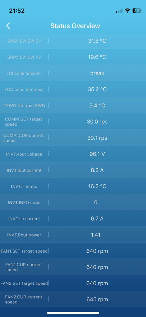

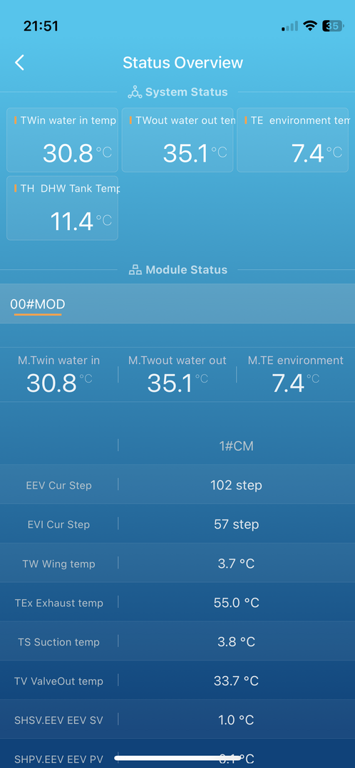

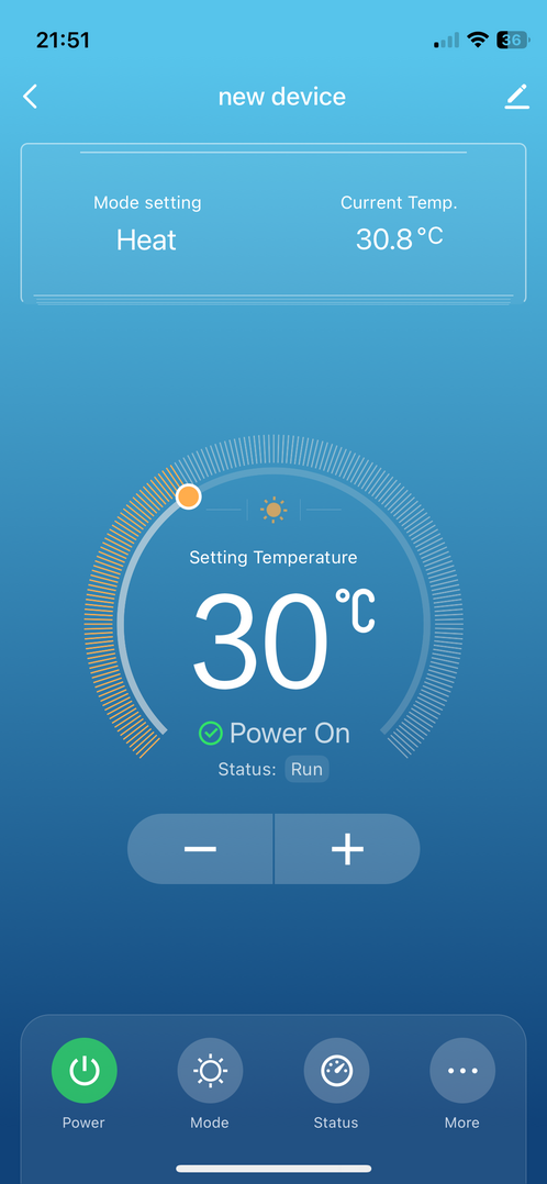

However, in order for them to have a fighting chance, some screenshots of the device now set up in the app would be good. @polar-bear, your phone should have an on/off button on the right hand side and volume up/down buttons on the left hand side. If you press the on/off button and the volume up button at the same time, you’ll take a screenshot of whatever’s on your phone’s screen at the time. If you can take screenshots of all the bits of heat pump info and settings you think might be relevant in the app, then upload those screenshots here we collectively should be able to decypher the important stuff.

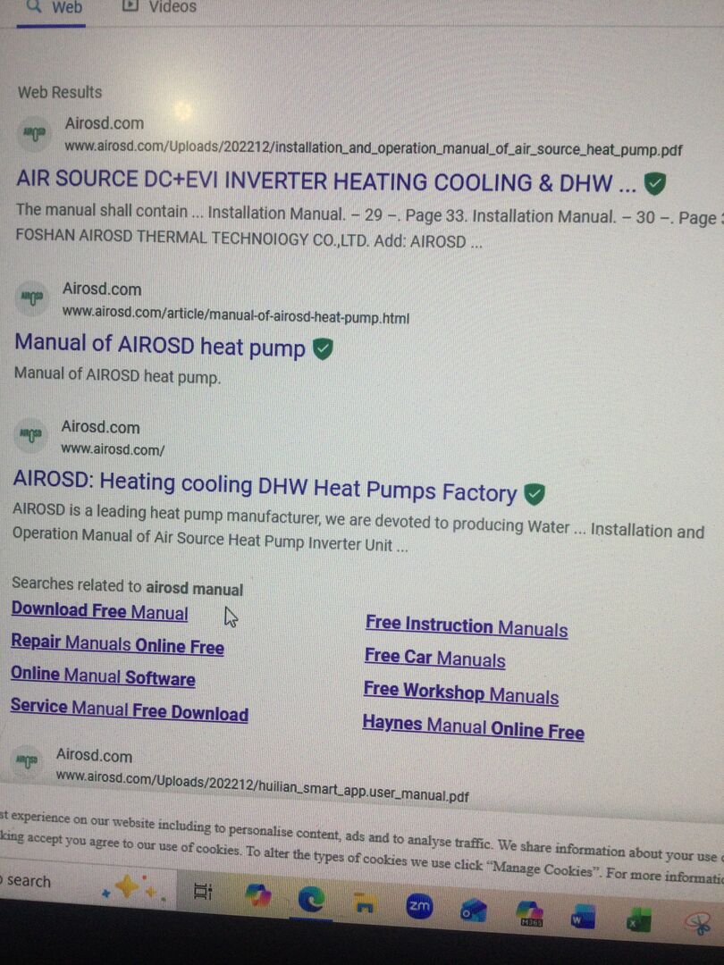

Also if you have a copy of the manual it would be useful to see it. The ones I have seen are really badly written and make no sense lol!

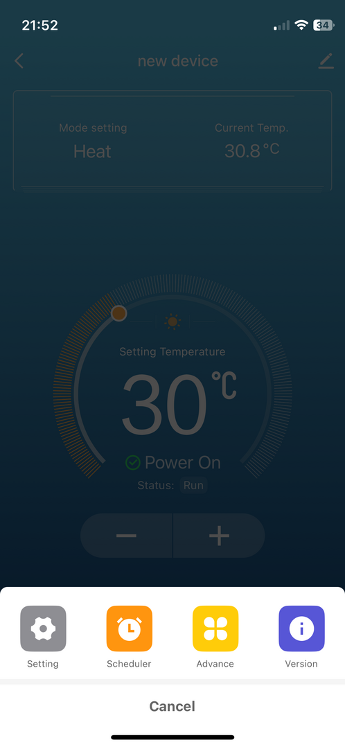

…and I’m assuming the “more” option on the right of the menu at the bottom of the second picture is the option that prompted you for a password?
The 'more' button takes me to
Setting/schedule/advance/version
It is the Advance that takes me to a password page....that's when I panic!
