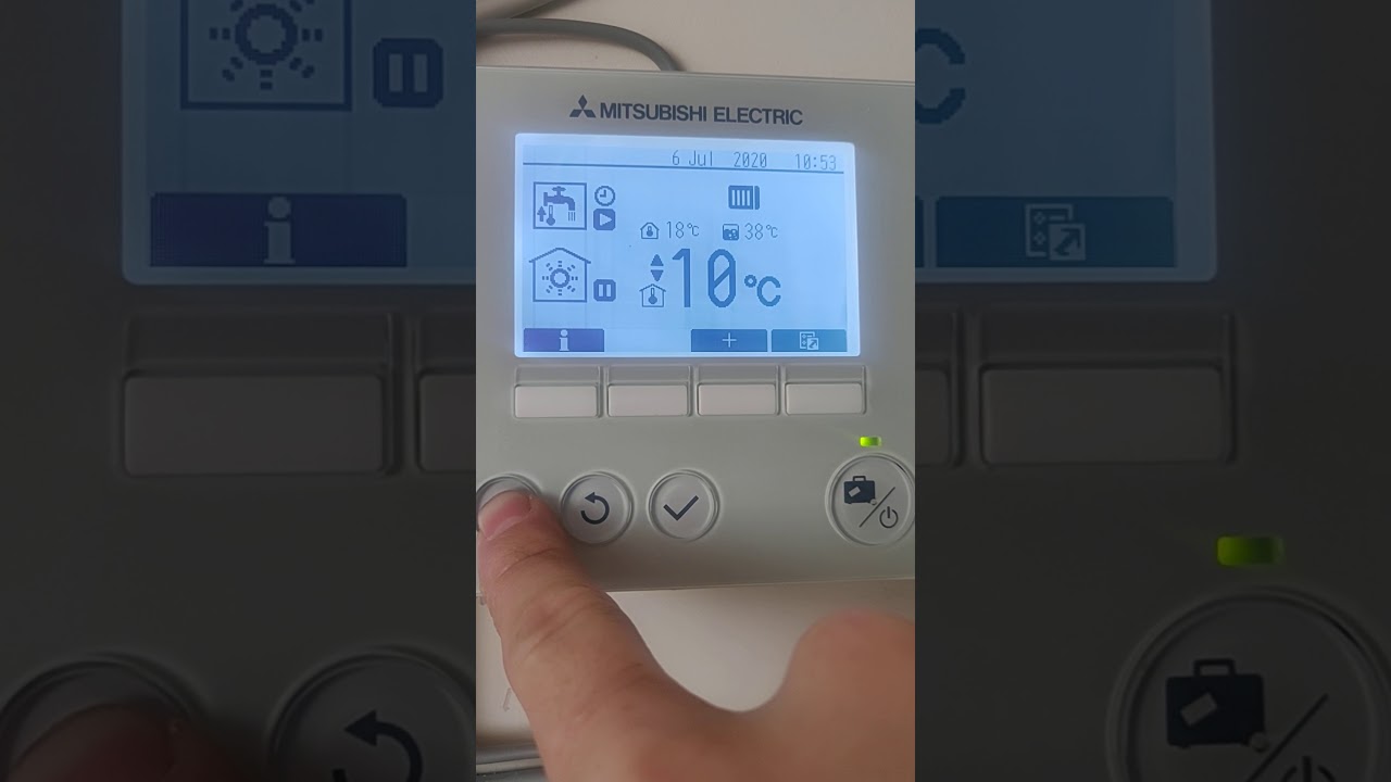

This will show you how to check and adjust DHW settings. He waffles a bit to about half way through then gets to the important bit so far as you are concerned. Hope this helps.

@m1kegibson Apologies if I'm teaching grandma to suck eggs but have you confirmed the max temp drop in the controller is set to 10C? To do that you hold down the menu button for a few seconds till the hot water/heating menu appears then under the tap symbol press the pen/notepad symbol then there you will see the options for the max temp set that should be 50, as that is what Melcloud is reporting, rhe max temp drop value, which you should check is set to 10C. Then there is the max operation time that will stop hot water cycles if reached regardless of the set temp so check that is set to a couple of hours. Lastly, there is the time limit that prevents it restarting even if its demanding heat but that shouldn't be an issue at this time of year.
If you are happy to post screen shots of those values then at least we can confirm its all set correctly.
