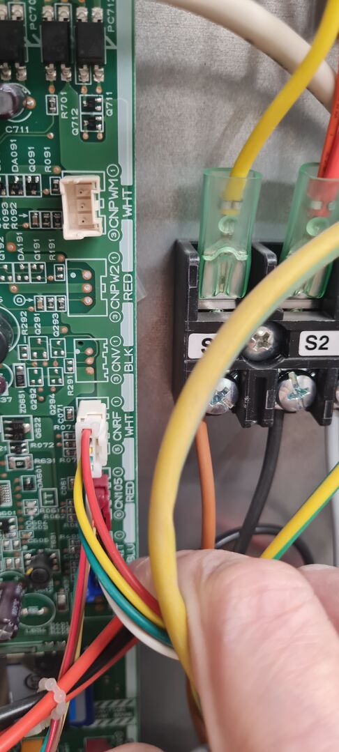

Photos of my indoor unit, it has 2 screw holes at bottom (fitter probably to tight to buy screws 🤪 as well as no flow meter ) then front lifts off.

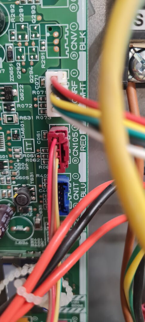

I followed exiting wifi wire to CN105 port.
I think (hope) unplug this plug in new dongle then plug existing WiFi dongle into EXT slot

@sand You are spot on,
The reason for isolation at the breaker is that this side marked in Red is at mains 230V and a bit too close for comfort with the CN105 Plug located at the White arrow - please take care with your fingers!

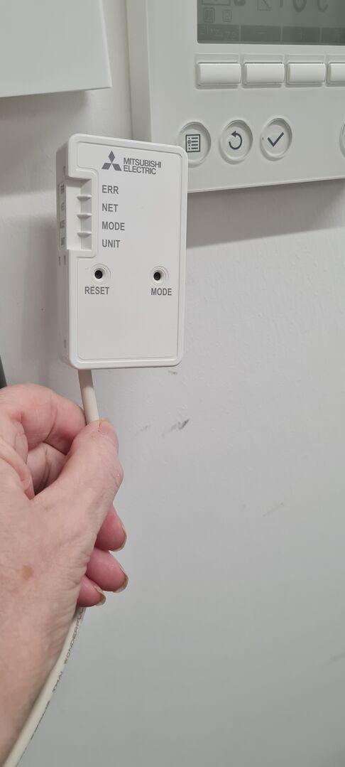

There is a magnet supplied at the top of the adapter so you can stick it to the metal case, or pop it out to reveal a screw hole if you have somewhere suitable to mount.

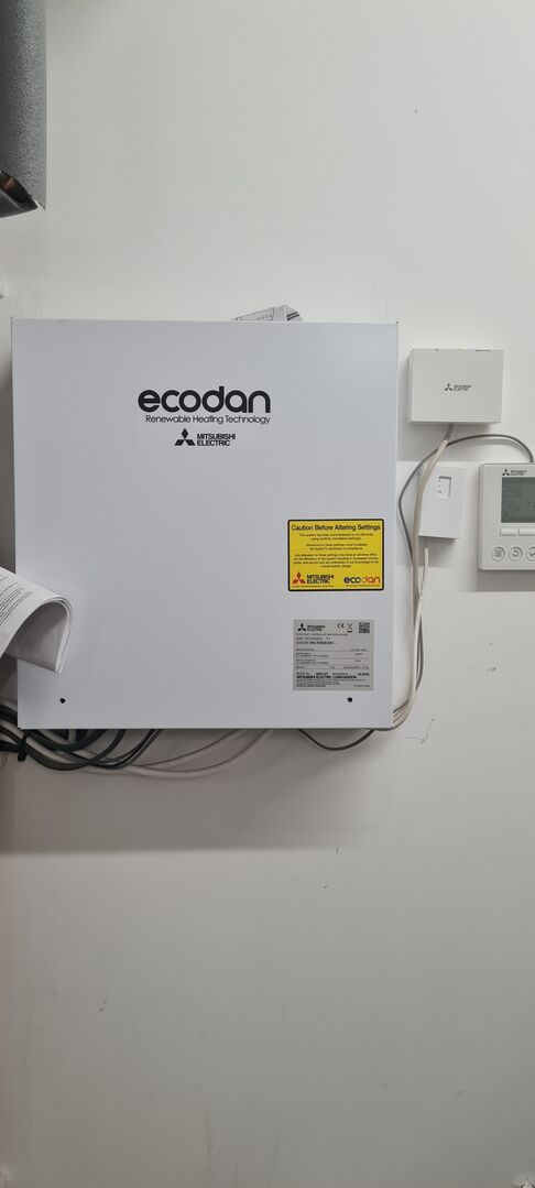

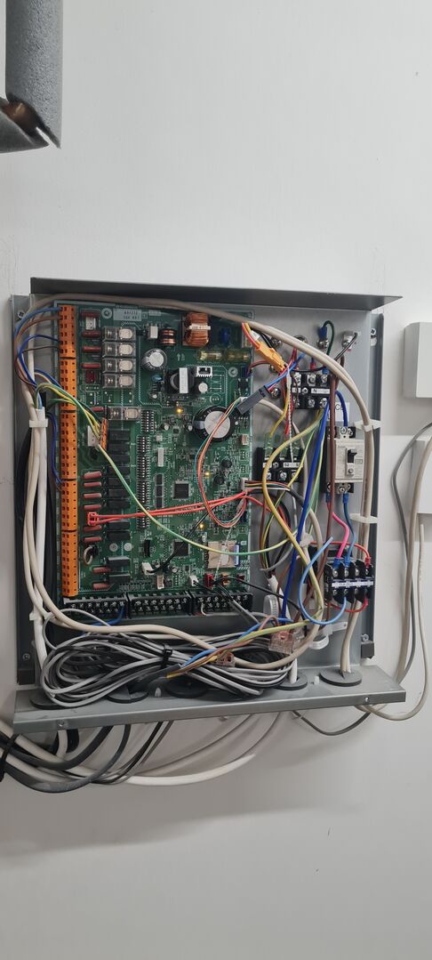

@sand I have 'location envy' for your white box compared to mine.
The electrician mentioned that he'd had to put it somewhere out of the way within the cupboard space, but he put the touchscreen display in a reachable place.
He said that there'd be no need for me to access the big box, which was a fairly safe conclusion at the time. Little did he know I'd find a reason, somehow!
@sheriff-fatman That's the right case, yes.
Note that this isn't the "hydrobox" design for Split rather than Monobloc units, which looks like these:

@sand Good to know that it lifts off, rather than swings as a hinge, as I wasn't sure it would have the clearance. I do have the same screwholes as yours, but I managed to erase one of them from the pic when erasing the label that had the serial number and QR code clearly visible in the picture (overkill perhaps, but it taught me where the option to edit was on my phone, at least!)
