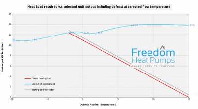

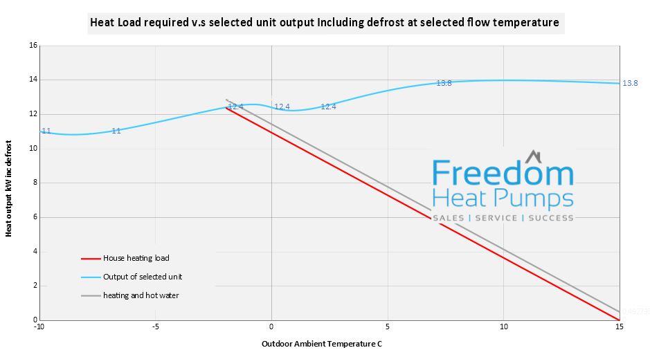

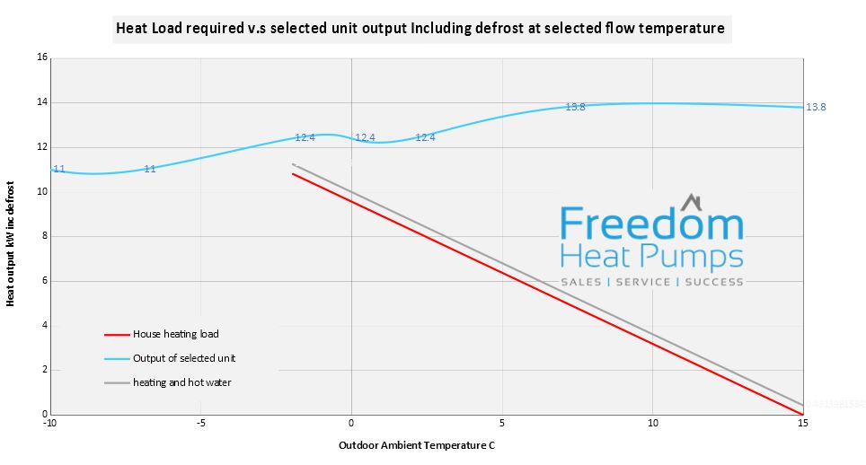

We know who wrote the Freedom calculator, and have done for some time. In it's native format, large parts of it are hidden (making it a 'black box'), but I have an aversion to black boxes, so I took the necessary steps to unhide the hidden parts. Unfortunately, most installers, mine included, just treat the black box as the oracle. While what you see in the black box is mostly rather clever, it is far from perfect. Rather than say vaguely I have 'loads of evidence' that it is far from perfect, I will show you some.
The calculator is based on the MCS approach, which is pretty standard. Whether it encourages designs with 'loads of headroom' is open to debate. I'd suggest the 'loads of headroom' stem more from decisions the system designer does or doesn't make (like what size heat pump to install). The actual calculations are of course fixed and rigid, 2 + 2 always equals 4, never 5, in a spreadsheet, and MCS itself is notoriously fixed and rigid in its requirements, with in effect a binary (0 or 1, about as rigid as it gets, there is no such thing as headroom in a binary world), and the spreadsheet reflects this: the proposed system gets either a pass or a fail. Very binary, no headroom.
In the hidden parts of the spreadsheet there are vast arrays of look up tables, stretching into the distance like solar panels across landscape. Much of the work of the spreadsheet is done by looking up data from these tables, and then producing the results the spreadsheets user sees. In passing, praise where praise is due: the formulae used are mind-boggling, GH is to be praised for managing to put them together. A classic example is the heat load vs selected unit output graph. Here's mine as sent to MCS by my installer (I got a copy after it was sent):

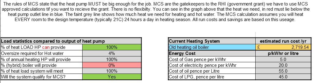

Unfortunately, the heat loss sheet contains a rather inconvenient typo. The external wall length in my largest room got entered as 2.3 metres when in fact it is 12.3 metres. Simple error, easy to make, but it makes a big difference, as we can see in the chart from the corrected version:
There is now no headroom at all. In fact, when you add the DHW, the head pops through the ceiling, into no no land. Nonetheless, the system is a pass, just, with no headroom. Below the chart in the spreadsheet there are some RULES telling what is and is not acceptable, and a table that has the binary outcome, Will the system qualify for MCS, Yes or No. In my case it was a yes, but there is NO headroom: the heat loss is exactly the same as the claimed heat output from the heat pump at design temps, 12.4kW for each figure. I don't see any evidence of MCS encouraging oversizing, or 'loads of headroom'. In fact, I see quite the opposite, no headroom. Here's the table, showing the system is an MCS pass:

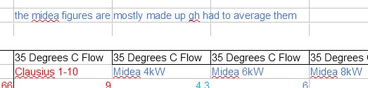

Now, and this is most unfortunate, the Freedom calculator guessed the output of the Midea units, and they guessed wrong. Unsurprisingly, they guessed upwards (they do so love their Midea units, better give them the benefit of the doubt). None of this is apparent to the ordinary customer or installer, it is all hidden in the hidden part of the spreadsheet. Look at the blue line in the charts, and the numbers on the line. They come indirectly (there is yet another trick in the spreadsheet pack of tricks, white text on a white bacjground, the actual plotted data is derived data in columns G and H) from tables in the hidden part of the spreadsheet. Note how the three 12.4 values aren't joined by a straight line. The curve is rather clever, it is in fact an X-Y scatter plot with an added smoothed line, that's how it gets the dip for the defrost cycles between 0 and 3 degrees ambient - otherwise, the three identical values would be joined by a straight line. It's really all rather creative, rather like creative accounting, and very pretty. But it is also wrong. And so too is the assertion that the system is an MCS pass. It's not, it's a fail.
Freedom (or rather GH) mostly made up the Midea figures. Buried in the hidden part of the spreadsheet, the part no one normally sees, is a cell with a very telling comment. This is what it says (screen grab for evidential purposes, and no Photoshopping, I promise)

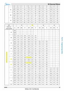

It turned out these figures are over optimistic. We now know, thanks to the diligent thoroughness of certain members of this forum, what the real, or at least the manufacturer's claimed figures (which may also be optimistic) are. Here's the data from the relevant Midea documentation (Midea_A_series_Mono_M-Thermal_Heat_Pump_R32_2020513_V1_7.pdf) showing Midea's claimed output:
My system was designed with a 14kW Midea unit, with a LWT of 55 degrees (a necessary compromise, because small rooms means smaller rads means higher LWT). I've highlighted the relevant cells. Midea use slightly different set points for ambients, 0 and -5, rather than Freedom's 0 and -2, but you can very clearly see that between 0 and -5 degrees ambient, the unit puts out between 11.5kW (at 0 degrees) and 11.1kW at -5 degrees. Let's say that means 11.3kW at - 2 degrees, compared to Freedom's 'mostly made up' (their term) figure of 12.4kW.
Unfortunately, 11.3kW is less than 12.4kW. My system is an MCS fail, despite the fact Freedom claimed it was a pass.
Now, where on earth has all that headroom gone?

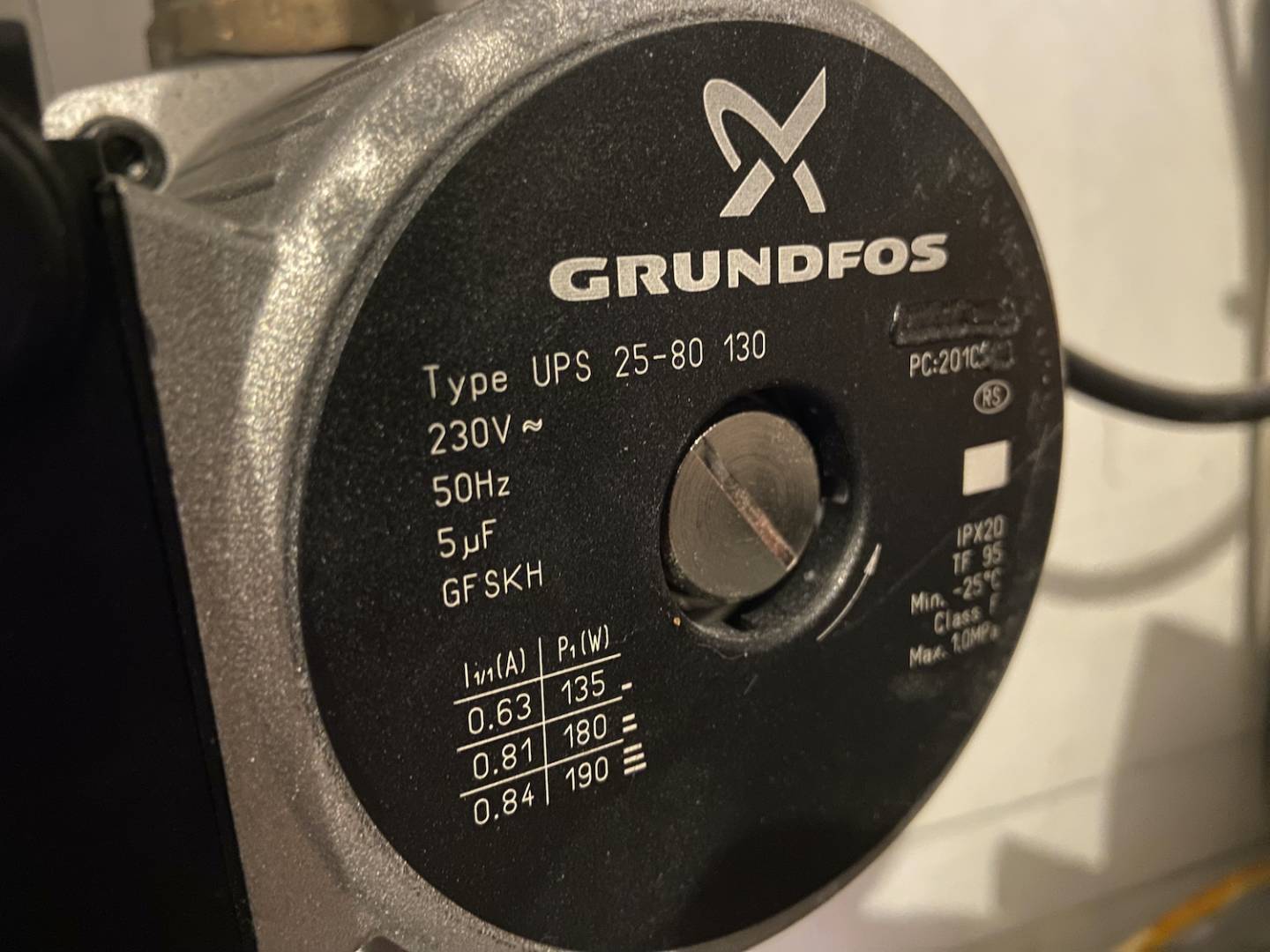

@editor I thought I remembered that Mars. Which circulation pump did they fit?

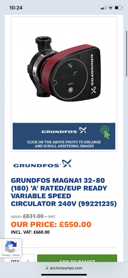

I have a Grunfos Magna 1 variable pump that only consumes 9-151W to pump around 24 radiators. This seems low power and good energy value. But it’s an expensive pump to start with

Posted by: @julianc@editor I thought I remembered that Mars. Which circulation pump did they fit?
They slapped in two of these in addition to the other two circulation pumps we have and at this time of year they have to run at max.
