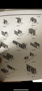

B47BD365 2E67 443C 908E CB36B54DAD47
These are the instructions - it may be installed in accordance as it only needs 100mm behind according this unless I’m reading it wrong

no other place to site it unfortunately - the installer never made me aware of any of this and claimed it would be fine as it’s within clearances. It’s also within 1m of the property boundary which is a no no!
The installer lacks imagination.
Even if the side alley is the only possible site (no rear garden), it's still possible to mount it hanging off the house wall on brackets 2m above ground level.
That solution was implemented on sites chosen by OVO for their BEIS-funded trial of HP installations in 250 houses during 2021. It was one of three such HP trials in England, costing £14m. And that begs the question of where is the 'report' which should now be available to us members of the public who have ultimately paid for those 750 installations! 🙄
BTW, is the large expanse of ice around that Mitsubishi ASHP coming from the condensation dripping from its radiator-style collector? There's meant to be an adequate condensation drain, which in your case would surely take the water to the nearby stoney area!
I doubt MCS would think this installation is compliant. Have you thought to mention this to the installer yet?
