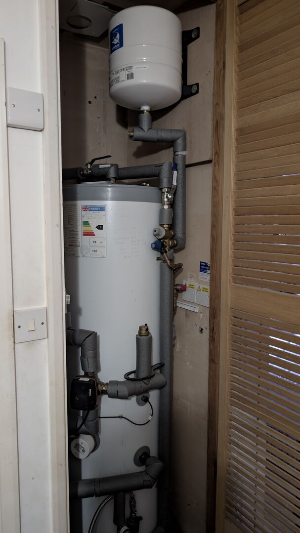

I also have a noise in the night. It is a loud cracking sound occurring at or shortly after the temp rises to 50c or above. The attached file is not my tank but the sound and tank is the same as mine. Since I am now running at 45c  and no legionnaires cycle I do not get it. Octopus sent an engineer but he could not reproduce it so I waiting anther engineer so I can show him the issue. Unfortunately the attached file though only 5 seconds is too big. I'll have to reduce it.

This is my setup which has more components.

Yes it does sound like that @jamespa  not really like water hammer. I wonder if there could be a problem with the expansion tank as it only occurs at higher temperatures. But some Octopus engineer must be aware of this as the clip appeared on FB. There is no water in the tundish indicating that the pressure valve did not operate. Annoying as mostly the installation works well.

FWIW I used to get expansion noises from pipework under the floor with my gas system.  Inevitably pipes move a bit, the coefficient of expansion of copper is quite high, and if this causes them to come into contact with something it will make a noise.  Yours may be no more than that and if so its nothing to worry about.  That said if the video you posted is the sound you are hearing it does sound like a more distinct noise.
