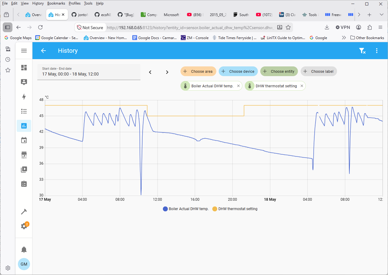

Hello all,
We have just had a Grant Aerona R290 installed and it seems to be having a problem in getting to the target DHW temp of 47c. It has a hysteresis setting of 6c and I recently discovered that it has a DHW temp correction of 2c in the Installation Controller - Main heat source configuration. It also has a DHW Set Temp of 45c on the controller display (but 450c on Econet24!). I suspect the latter is a default value though.
I think that the real target would be 47c plus the temp correction of 2c giving 49c. However, would it be "satisfied" if it came up to the hysteresis value of 49-6? Aaarrgghh! (It was much simpler with our older GSHP.)
I reckon this results in the HP attempting to get the DHW up to temp and therefore cycling as shown on Home Assistant:
I do not understand why the heat pump would just stop attempting to get the temp up to target.

Just in case someone else has the misfortune to come across similar issues and finds this topic...
The installers responded quickly - fair play to them - and had Grant on the phone while they were here. There was quite a bit of discussion which resulted in a curve of 1.0 for one circuit and a DHW temp correction of 5c under Installation Controller - Main heat source. The sensor was moved to another pocket as the original position would have meant incoming cold water would have influenced it quite directly. Working well now but the term hysteresis in this case does not mean a buffer above and below the target temperature, merely below - 6c in our case.
