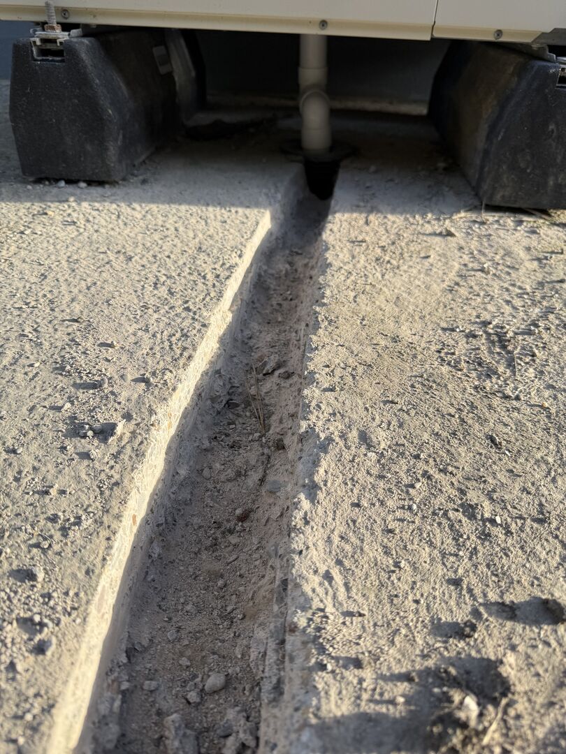

So the Lone Ranger returned today! Even though we thoroughly described the fault and them agreeing it was probably the diverter valve, geuss what they did not come prepared with? OK maybe I am being a little unfair as they need to order the part but still. When we heard the clunk he said “yeah thats the coils in the tank!” So I asked is it normal and he said it is an issue with the Honeywell diverter.
Interestingly he said that it is well known that the Honeywell diverters that come with the Grant Aerona kits are prone to failure hence Grant has changed the ones they use now, my response to this was why then did they install it in the first place!
So once he climbed on his trusty steed Silver and rode off into the sunset he shouted something very non comital about coming back next week with the new diverter valve.
Oh and despite lots of grunting and straining, the compression joints on the mag filter and flowmeter are still leaking!
Ending on a positive note he did dig a channel to help the condensate drain away from the unit. And he will concrete over it when he comes back.
IMG 0722
However he seems to be ignoring the fact that the condensate is coming out of the side of the tray not the drain hole!
Hi-Ho Silver indeed!
