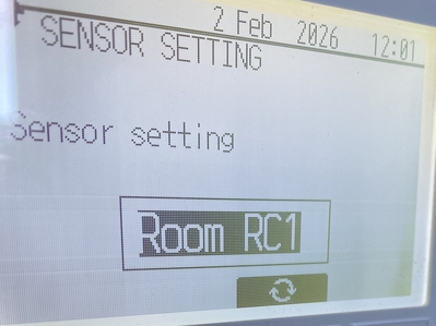

@f1p Thanks for your interest. Yes it is set for Room RC1. I am going to move the Par 60 from the second coldest room in the house to an upstairs bedroom, currently registering 21C on a Shelly Gen 3, and see what happens.

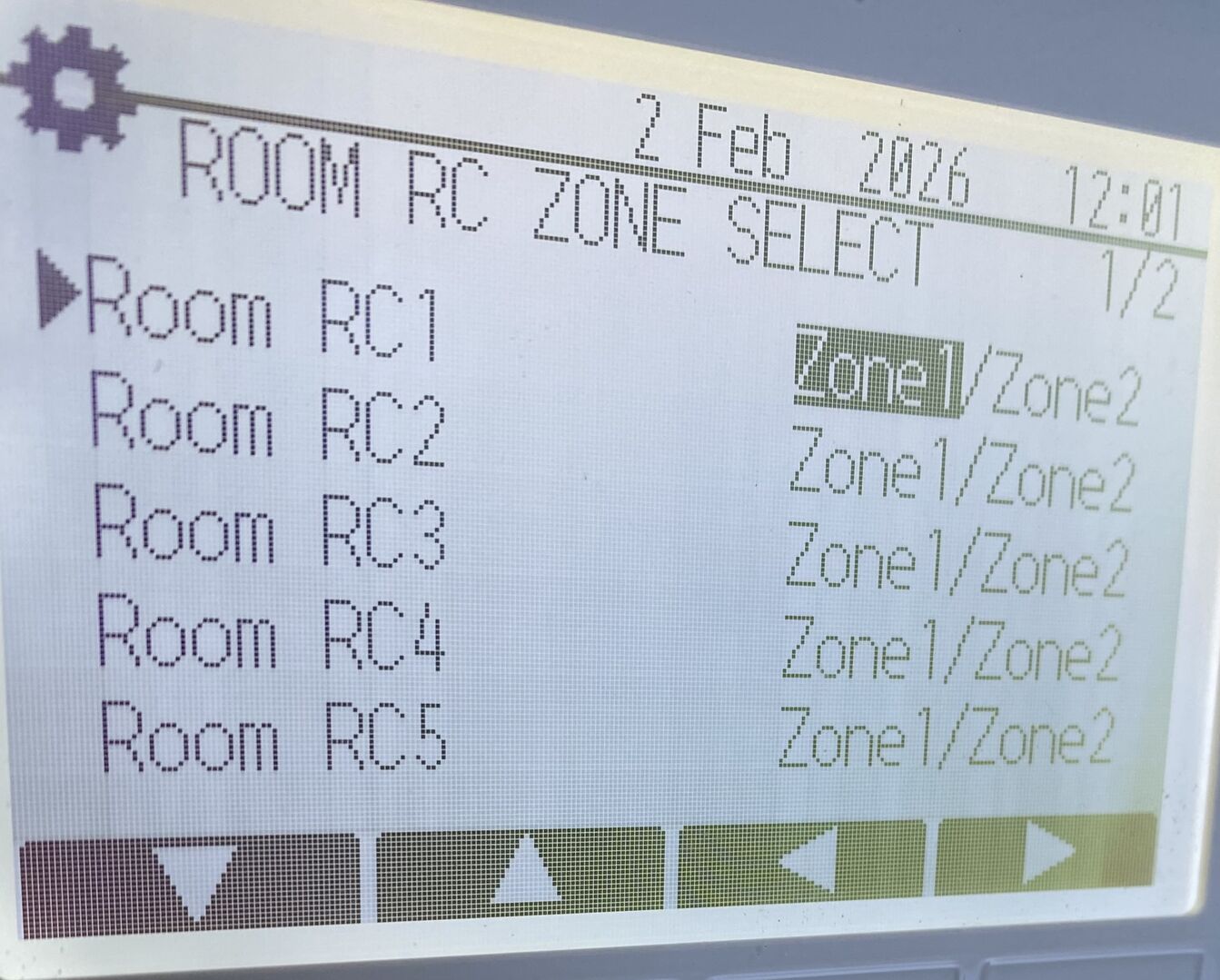

The default for an unpaired or incorrectly assigned thermostat is also 20, could you further check:
Initial settings > Room sensor settings > Room RC zone select > Room RC 1 = Zone1 (black background)

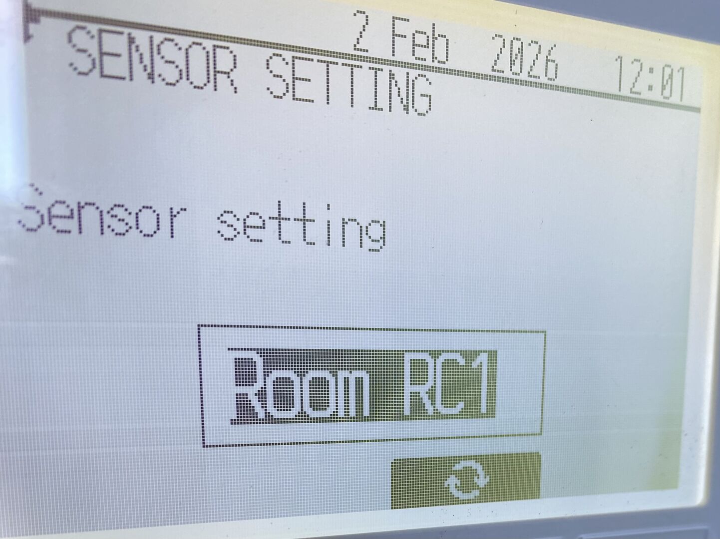

@f1p1p I have checked both and believe them to be correct, (see photos), but I would appreciate your confirmation.

The settings look correct, and i see you now have movement in the value - so it appears to be working.
I know there is some filtering, but is it accurate or is there a difference with other sensors?

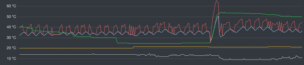

The detailed report is here:
https://melpump.com/public-report/view/019c1e2a-6844-7aeb-9f9a-f0f6270fe56e

The DeltaT is pretty high, by the sounds of it flow rate too low for the outdoor unit size
Pump might be set on 5 - but potentially it needs replaced with a larger circ pump
It's quite impressive you are pushing 44C flow at a freq of 26Hz

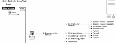

4 As reported, I can find nothing to switch off the second pump which you record, but I can see a hidden menu item for selecting reporting on multiple pumps, here.
Screenshot 2026 02 02 at 15.12.36
Is that what your system is seeing?

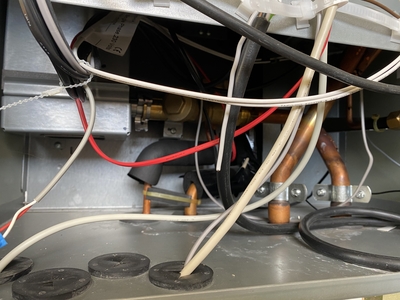

5 The strainer is not very accessible (see below) and may require removal of the main PCB so I need to be sure I am on the right track before tackling this.
Is this a cross post with someone elses suggestion? I'm not sure we wanted to - i haven't checked the Hydrobox schematic as to see if there is a zone pump in addition to the primary circulation pump
Shame that strainer is difficult to access
Madness, like putting the oil filter somewhere that necessitates removal of the engine before cleaning it.  Unfortunately, inconvenient as it is, it will need to be checked.  Mine, after just six months in a system that had been well flushed, was totally blocked.  Perhaps consider fitting an additional external strainer so that the internal one is 'protected'?
