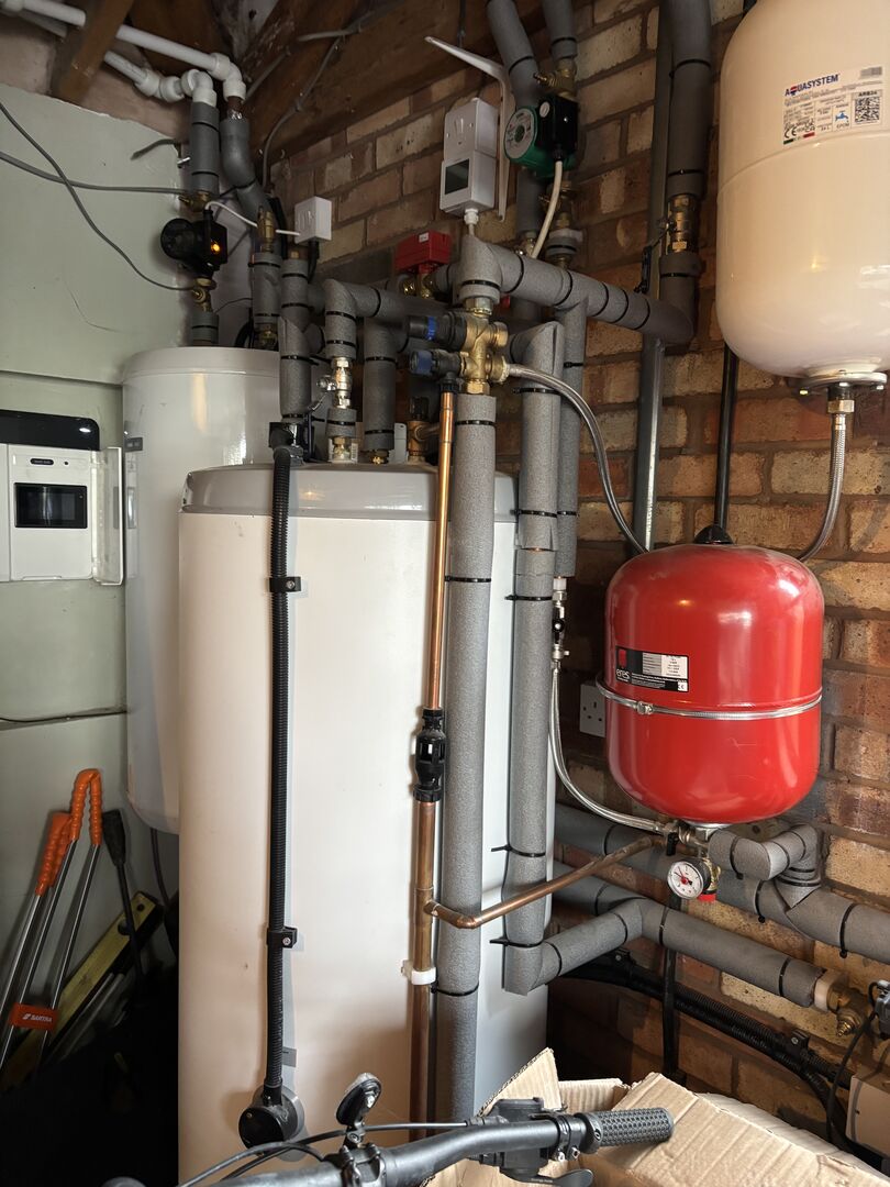

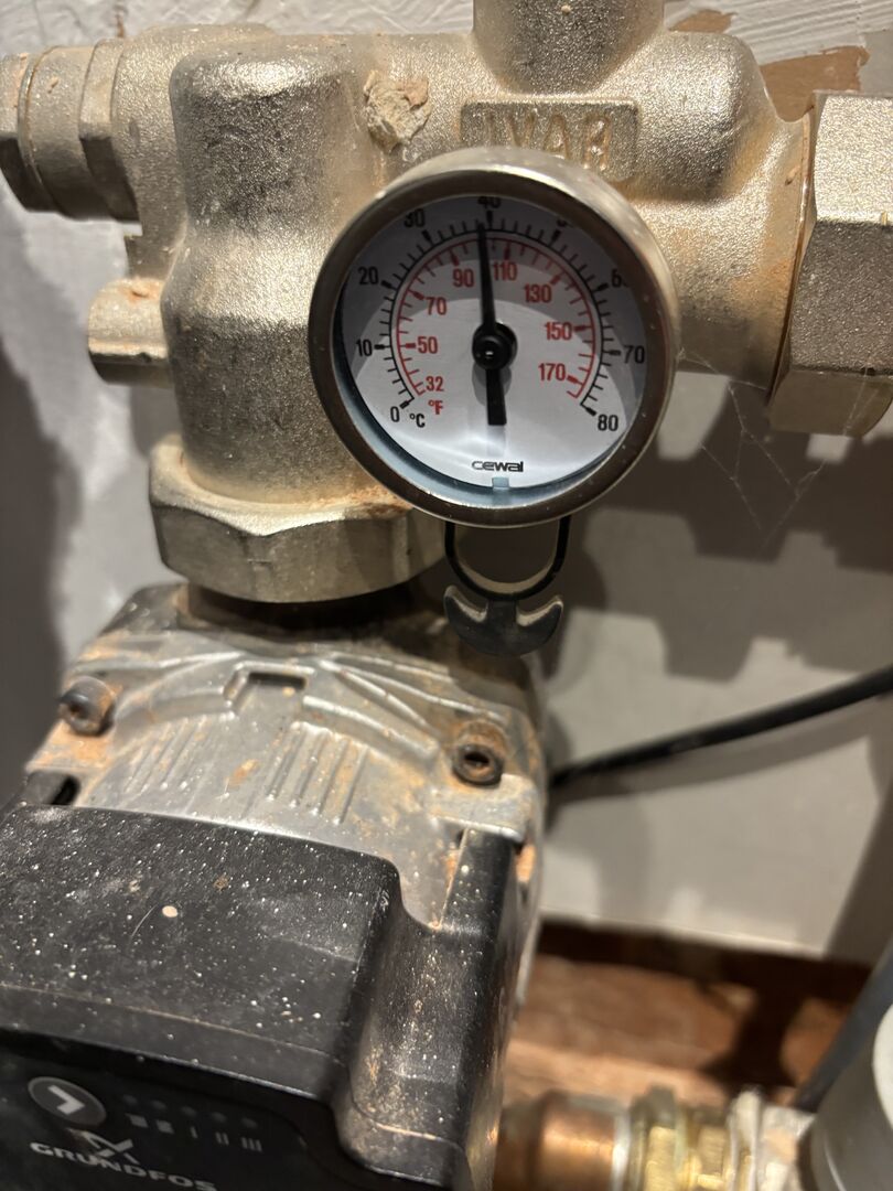

@jamespa I’ve attached a picture of a temp gauge on one of the manifolds. Not sure if that’s what you’re referring to? We only have underfloor pipes now. The heat curve was set at 0 so I’ve increased it to 1 but you did say to decrease it should I leave at 0 or put lower?

Thanks for the pictures, they tell quite a story but nothing you can immediately do anything about.
The gague is a measuring device not something you can adjust.  The value it shows suggests that adjustments would likely be beneficial.
Unfortunately its not going to do any good at all changing things individually.
You need to
Turn all thermostats including any heatmiser ones to max
Turn the mixing valve to max
Operate the heat pump 24*7
The house will very likely overheat
Only once all of the above are done
Turn the heating curve down until the house is at the right temperature, making a change not more than every 24 hrs
If necessary balance the loops to get the relative room temperatures right.
What you are trying to do is to heat the house with the heat pump at the lowest possible flow temp, which occurs when the output from the ufh just equals the loss from the house and everything is operating continuously.  Fortuitously, for most houses, this is both the most comfortable and the lowest cost, perhaps the only example I know of thermodynamics working in our favour!
I would not recommend doing any of this until you understand it all, and I am happy to explain it if you tell me what you dont understand.
If you post a picture of the manifold I can probably tell you what various bits do and which ones you may need to change.
Also, how many water pumps can you see in total?
